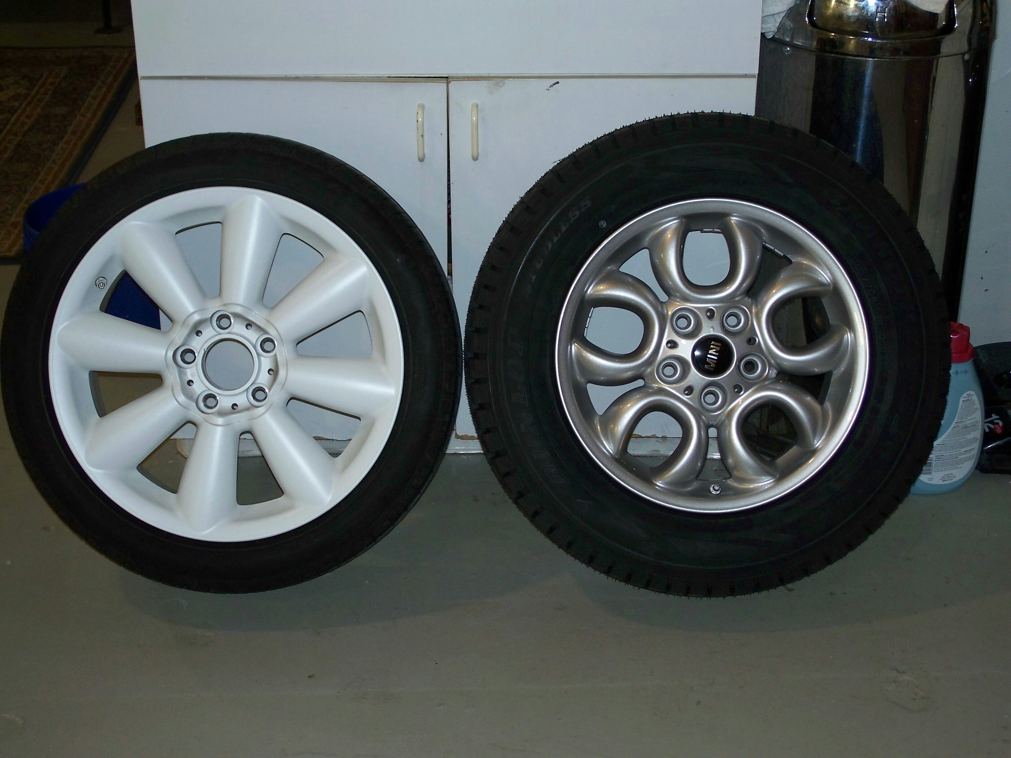

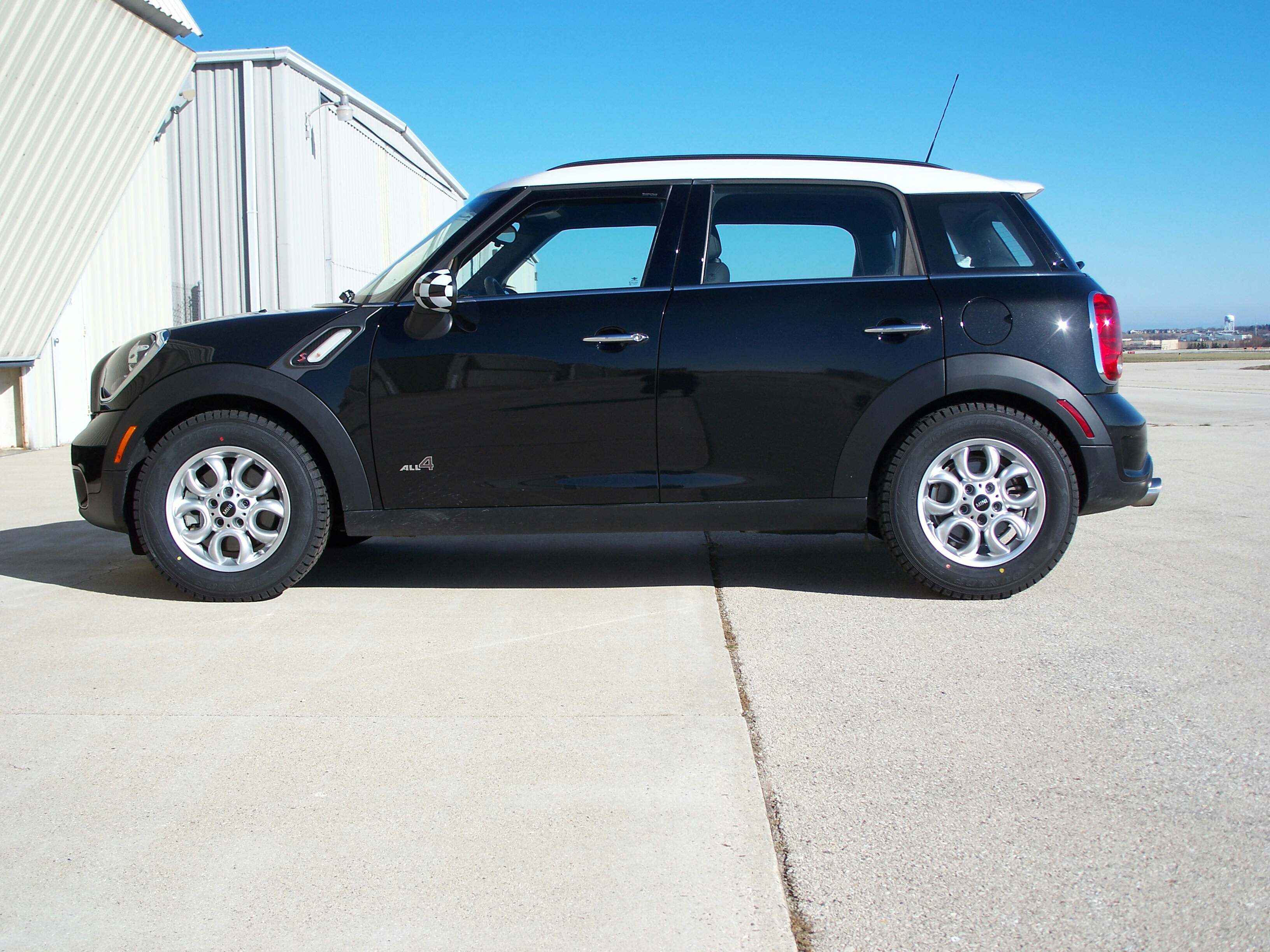

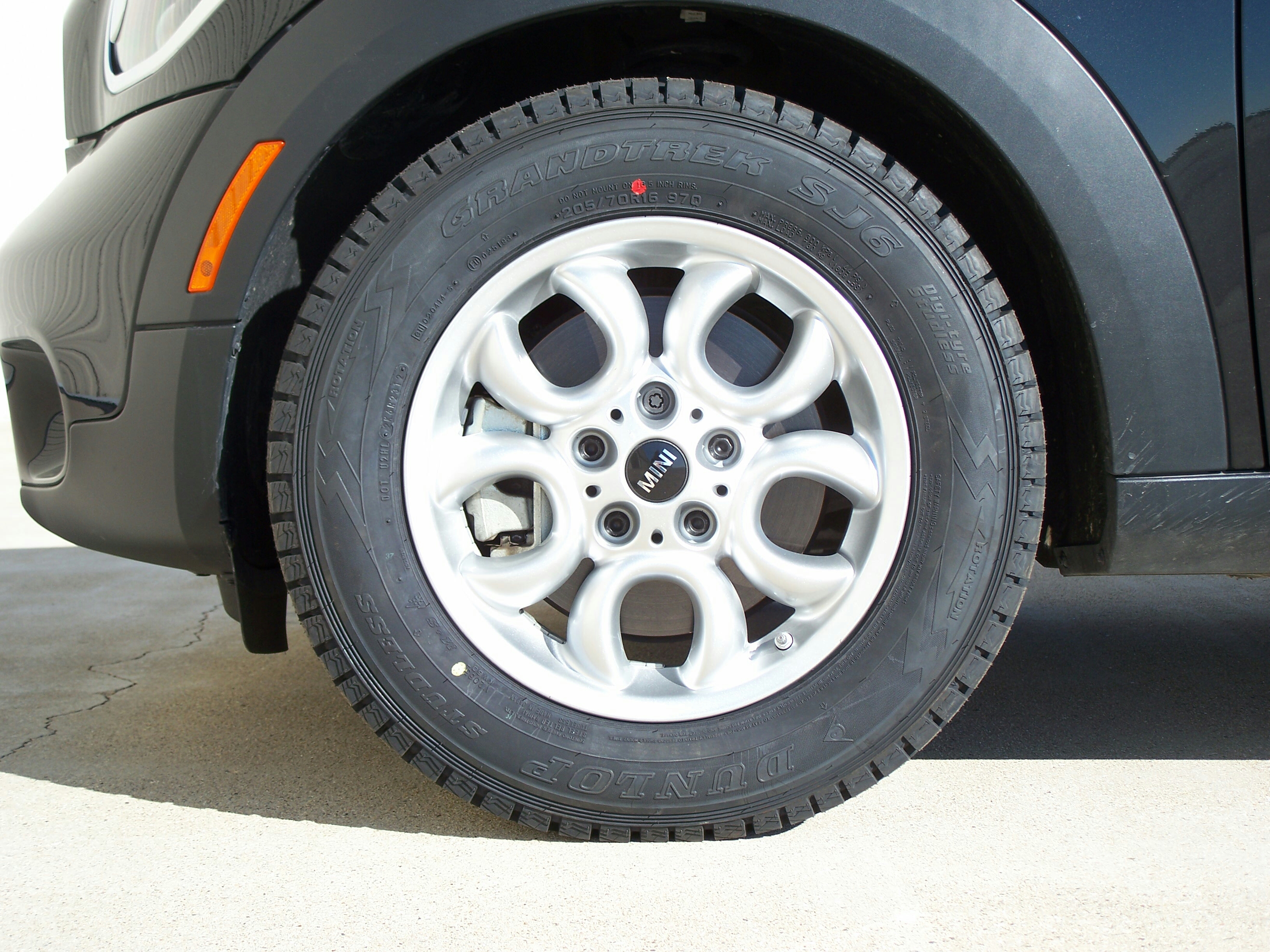

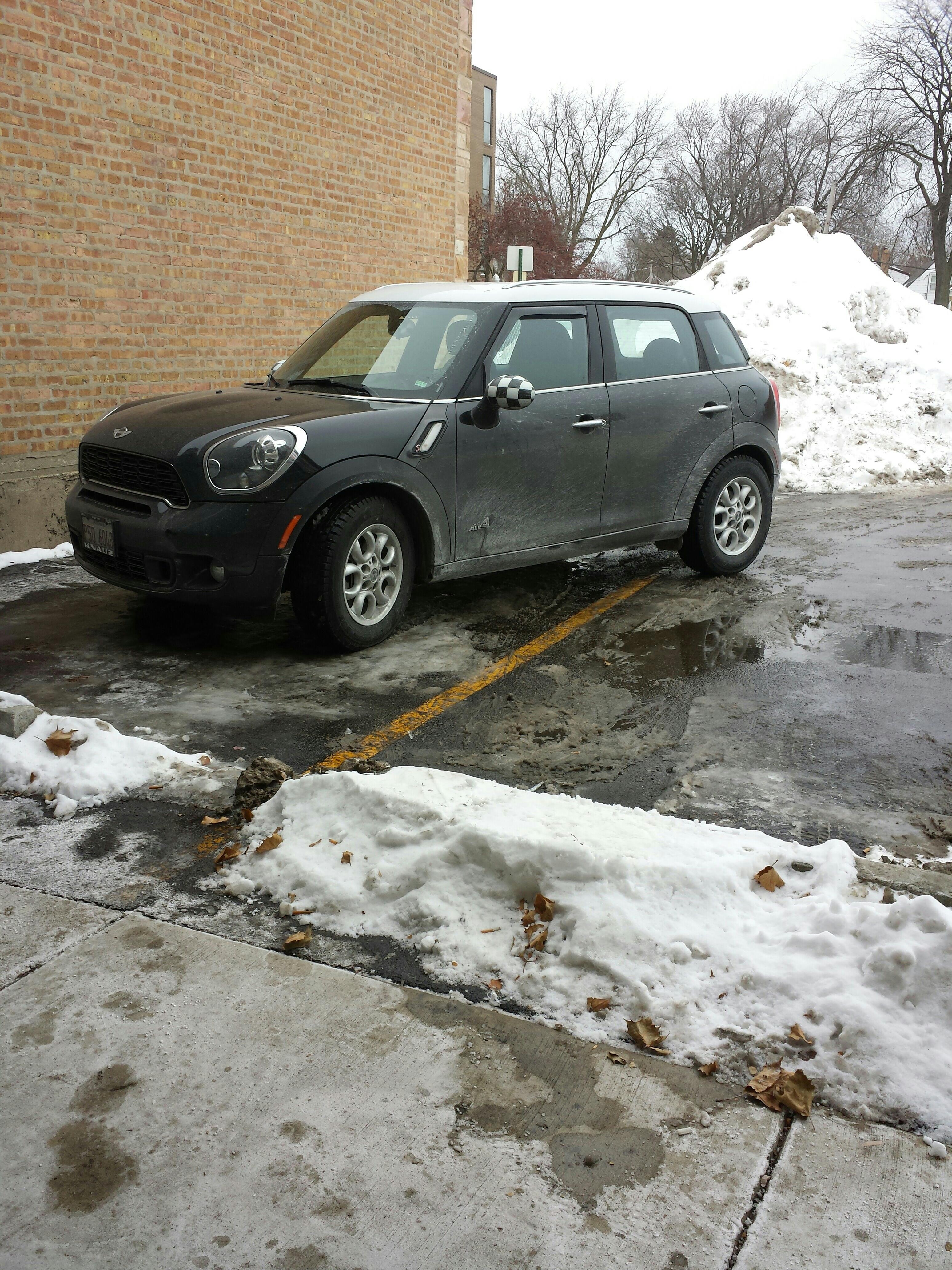

i am running 205/70R16 (27.3 OD) on 16x6.5 et 46 wheels on my all4 with factory sport suspension (10 mm lower than standard suspension) with no rubbing even with the car weighted until sitting on the bumpstops
215/70R16s on the same wheels just rubbed in the rear when on the bumpstops and in front just rubbed at full turning lock when on the bumpstops
photos white wheel is oem 225/45R18 (25.9 OD) on 18x7.5 et 52 wheel, silver is the 205/70R16s
