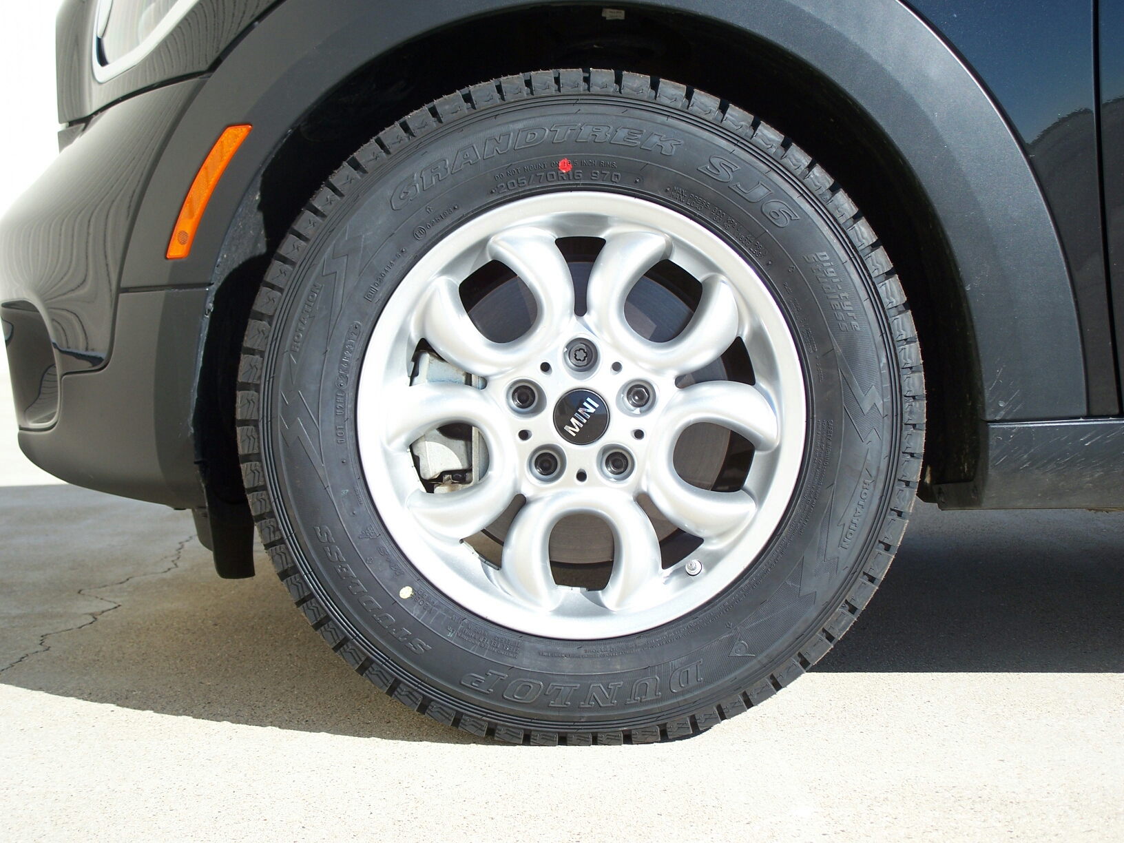

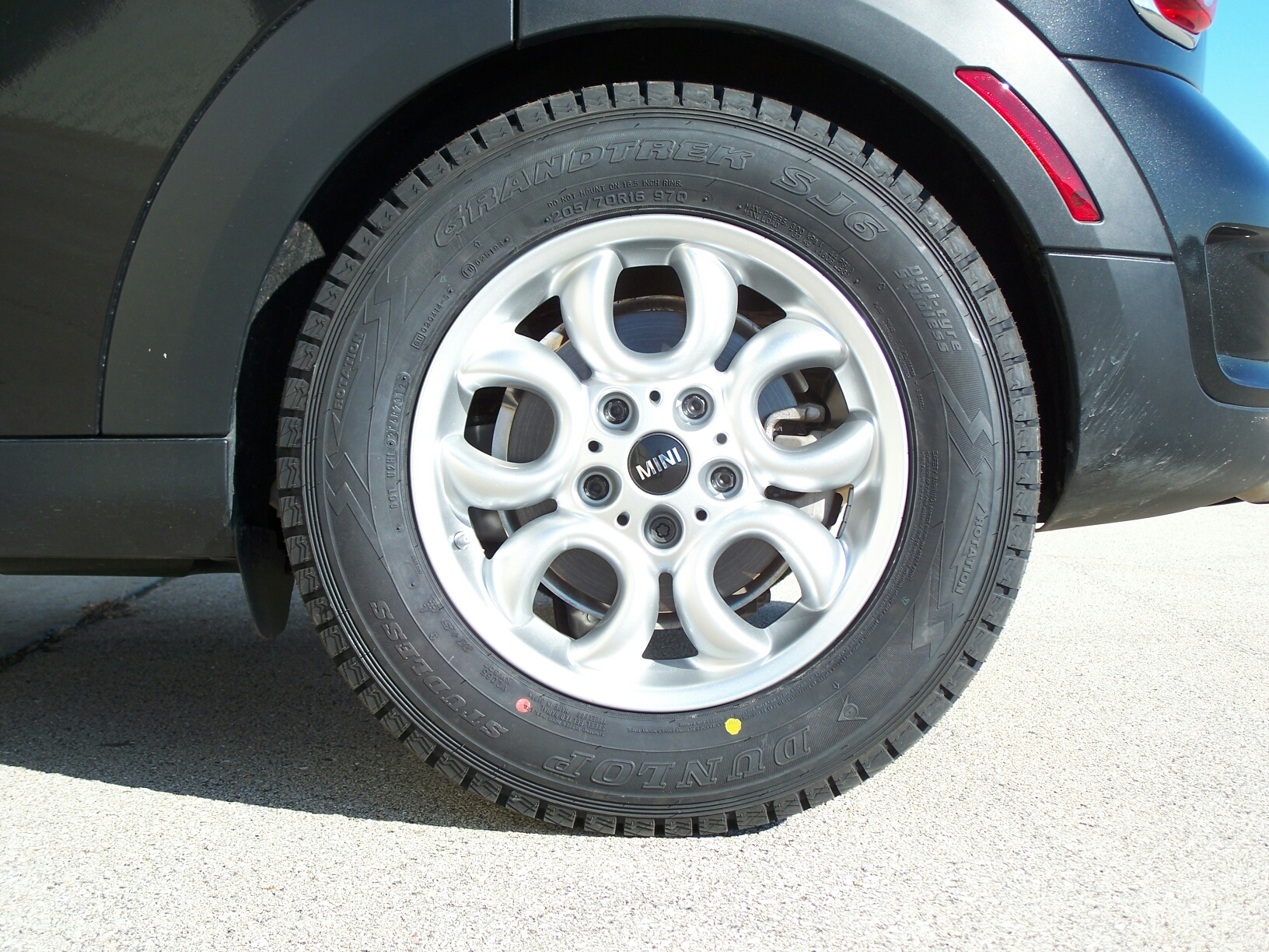

you can run mini oem 16 inch alloy wheels on your cms jcw
i run them for my winter tires and we test fit one on a jcw at my dealer
photos 16x6.5 et 46 mini alloy wheels with 205/70R16 dunlop grandtrek sj6 studless ice and snow all-terrain tires
