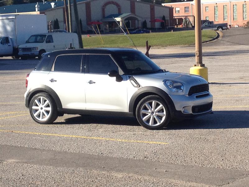

i am sticking with the stock 18" turbofan wheels, but up sizing the tires from 225/45R18 to 225/50R18
this will increase diameter from 25.9" to 26.9", filling the well nicely
i am running 205/70R16 winter tires now, diameter 27.3"

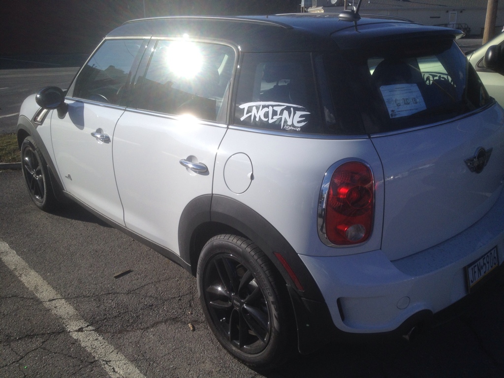

I have been trying to find a good size for my Countryman that are wide but don't rub.
Thinking about trying these wheels.
http://www.jegs.com/i/Ultra-Wheel/605/421-8812B%252B40/10002/-1?parentProductId=1731316

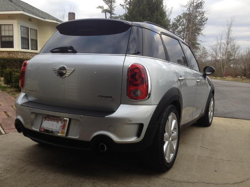

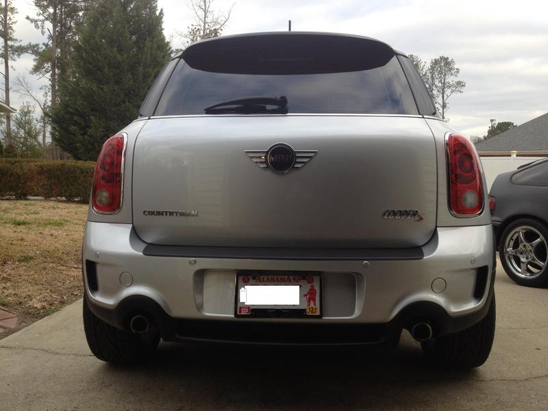

19 x 8.5 et45 wrapped in 245/40 will most assuredly NOT work on a car lowered significantly on coils. But it will be fine with the sport suspension or even lowering springs. That is roughly the setup that kconner and MotoGreg are running on their Countrymen.
I had a set of Beyern Bavaria 10-spoke wheels in 19 x 8.5 x et40 wrapped in 245/40 tires and it was pretty much rub free even with NM lowering springs. I very much doubt it would rub on the factory sport suspension.
