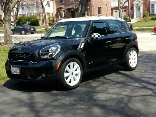

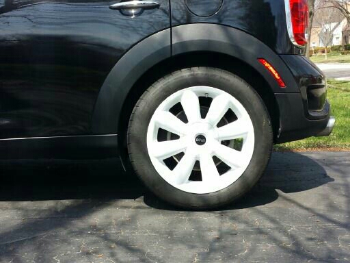

yes, i am running michelin pilot super sports in size 225/50R18 with oem turbofan wheels and sport suspension
no issues at all AND my speedo is spot on accurate with the 1 inch larger OD tires (26.9" vs 25.9" stock)

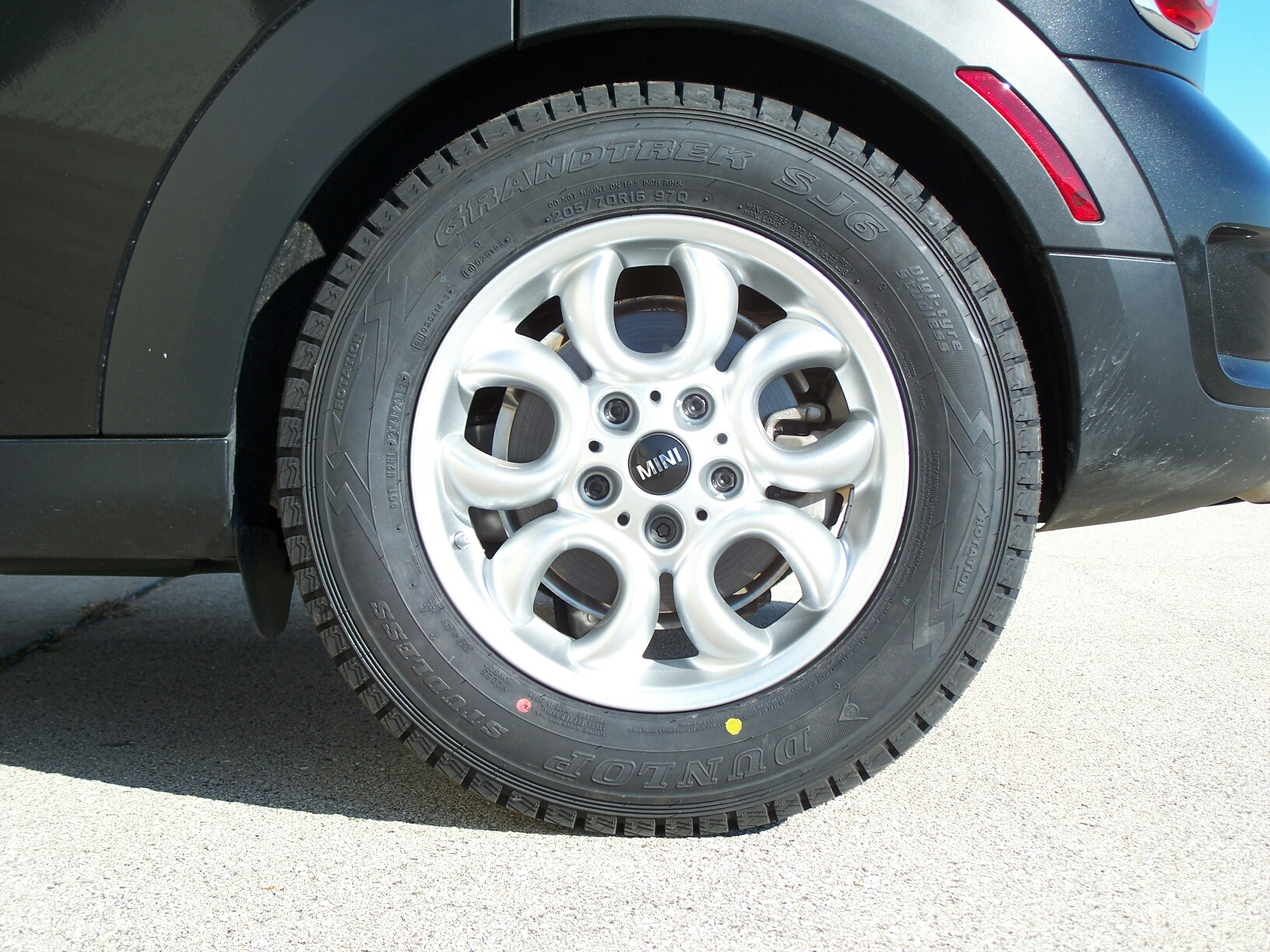

but for winter, i got a set of 16" oem alloy wheels from ecstuning and run dunlop grandtrek sj6 205/70R16 (27.3" OD) studless ice and snow AT (all terrain) tires
the 205 width better penetrates the snow and the /70 sidewall better protects the wheels from potholes ... 3 Chicago winters and no bent wheels

white wheels = 225/50R18
silver wheels = 205/70R16

Dan, on my cms all4, 215/70R16s rubbed in front at full lock. They were mounted on 16x6.5 et 46 wheels. On the rear, it was very close to rubbing the rear fender plastic trim at full extention.

Thanks for that.
I was going to fit the 215 with a 15mm spacer until I saw the photo of your rear wheel arch with the 205 very close, so it's 205/70/16 for me.

I put the 205/70R16 winters on for the winter of 12/13. Just put the second set on this fall.
Never had any rubbing with them.
The ride is plush considering the rough shape the roads are in all winter.
