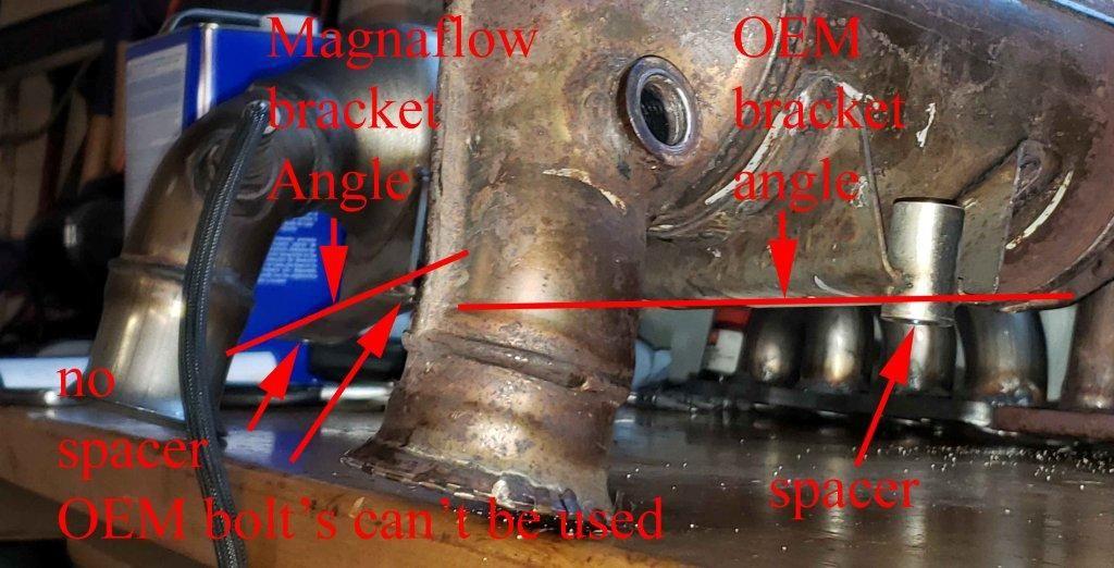

Well Ivan, It looks like the manifold I received was built by the shop idiot.
First, the bracket that attaches to the catalytic converter is at a much different angle than the OEM manifold. This results in about a 10 degree difference in the angle of the discharge end of the manifold where it connects to the exhaust system. This offset puts way too much strain on the flex coupling that connects to the manifold. In the thermal image below, the white lines represent the manifold lay line; you can see the angular difference at the flex joint. I also have a very nice exhaust leak here. Yes, that's a new clamp.
If that wasn't enough, I had to grind down two of the welds because the nuts would not seat properly with the manifold flange; that will result in improper tension on the stud and more exhaust leaks if not corrected.
But wait there's more:
The lower mounting point was so long, it interfered with the transmission housing, and after I cut some of the end off, I also had to remove some of the bracket material because there was no clearance between the bolt and the bracket. Additionally, you can't use the factory bolts; you must replace them with 1 1/4" bolts; the factory bolts bottom out since there are no spacers on the Magnaflow manifold.
And finally:
I had to alter the heat shield because the cylinder portion that protects the up-stream O2 sensor was hitting the weld for the O2 sensor boss. This made it impossible to get the O2 sensor socket on the sensor.
Summary:
This is probably the worst fitting aftermarket part I have ever attempted to fit to a car. I plan on removing it and installing the oem manifold unless I can figure out a way to correct the misalignment issue where it meets the exhaust system flex joint. I was even thinking about taking the car to the local dyno to see what power I'm producing now and then check it again when the OEM manifold on the car. I'll report back if I get the dyno work done. I'll bet the performance gain is <10%.

Wow, I can't believe that had so many issues. I had to use spacers too, and found things to use in my garage. I did not have the other issues you had. Mine fit without issue. I did have my flex joint break off my exhaust as I was getting ready to put it back together, so I found a universal flex joint that was the same size and welded everything back up. The bottom of my assembly was angled perfectly to meet up with the exhaust, and all of my shields are back in place. I can tell you the performance gain of my car is fantastic from every angle. I don't understand how yours could be so bad.

I can't either! When I sent all those pictures to ECS Tuning, Chris told me they have sold many of these manifolds without complaint, and he offered to refund my money. It figures I'd get the one build on Friday afternoon before the 3 day weekend; today I wanted to give it another try. In the end, I persevered! This manifold sounds a lot different than the OEM. I managed to get the exhaust system to align with the manifold, but it still sounded like I had an exhaust leak. I used my thermal imager, steam, and my mechanic's stethoscope to ensure I didn't have any exhaust leaks at the cylinder head and at the exhaust clamp, but but is sure sounds like I do with slight load on the engine. Did you have a similar experience? With the engine running at idle (AC off), everything sounds normal; as soon as I turn on the AC (and pick up the load of the compressor), it sounds like I have an exhaust leak, but I don't. More load on engine = more fuel, and a corresponding increase in noise ... makes sense to me.
Still, I shouldn't have to grind down welds and cut brackets to get the manifold to fit correctly. Good thing I'm not Magnaflow's quality engineer!
