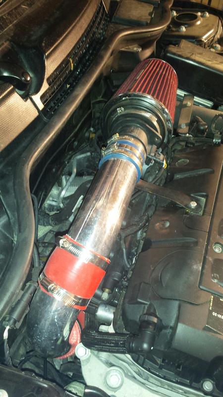

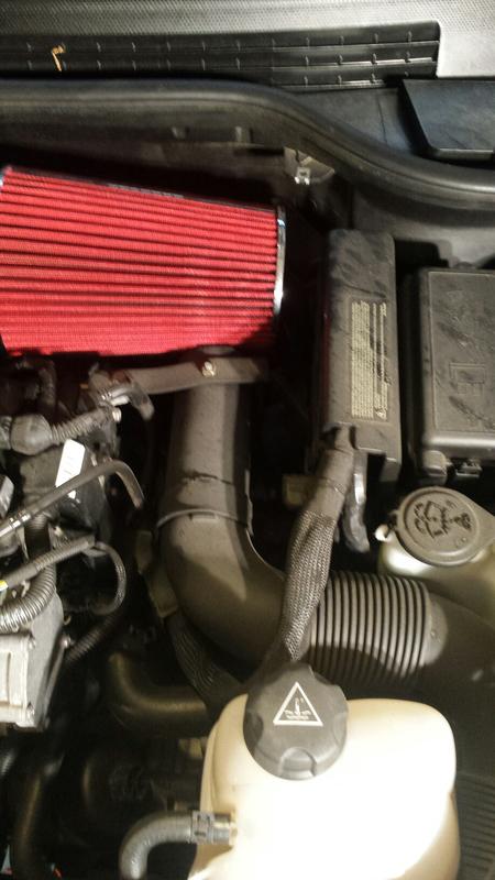

Old May 3, 2015 | 05:11 PM
Mreynolds84's Avatar
Mreynolds84
Joined: Aug 2014
Posts: 9
Non-S CAI Functional Differences
my intake built for around 50-60 bucks
Attached Thumbnails Non-S CAI Functional Differences-20150501_151612.jpg   Non-S CAI Functional Differences-20150501_151623.jpg   Non-S CAI Functional Differences-20150501_151630.jpg
Old May 4, 2015 | 05:07 AM
Aquasar's Avatar
Aquasar
Joined: Apr 2004
Posts: 1,426
From: Sumter SC
Nice whats it sound like? I do notice that it is several inches to the right of where it would have been mounted!
Art
Old May 4, 2015 | 06:51 AM
Mreynolds84
Joined: Aug 2014
Posts: 9
it was originally mounted in the factory location but it didn't seem to do more then make a little noise so I extended it to give the air more time to smooth out. Now it is a noticeable difference pulls hard in the middle of the rpm range and growls loud. eventually going to add a box around the filter and larger bore tubing to fresh air.
