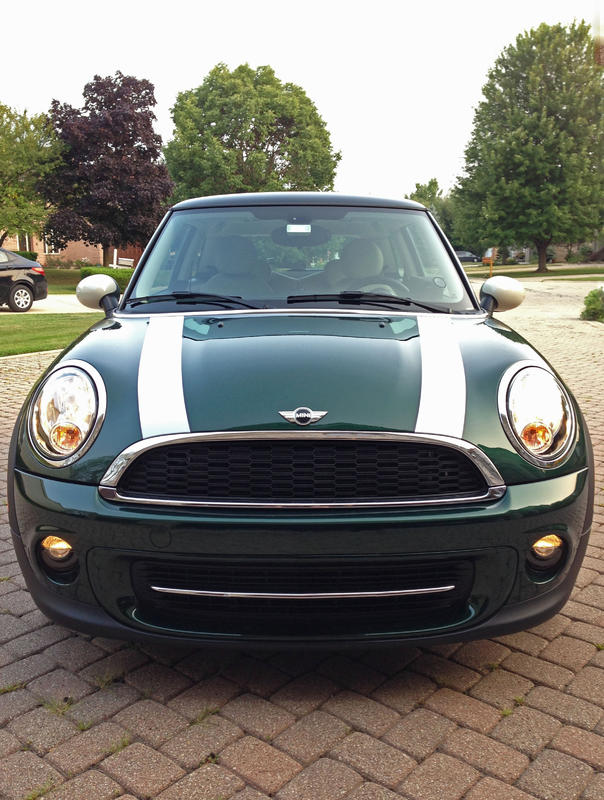

It's actually not that difficult. The chroming on the grille surround is actually quite nice and substantial, so it does't chip off like one might expect. Here are some tips to getting the job done:
- tape a small piece of paper to the corner of your original grille surround (once off the vehicle) and trace the outline. remove it and cut it out to create a nice template for the new trim piece. you only need to make 1 template since both sides are the same, just flip it over. match the top outer corner and bottom edge of your template to the new trim piece and transfer the outline.
- cover all surfaces of the new piece that are to be trimmed with masking tape. this allows you to trace the outline and it protects the chrome from scratches and chipping when cutting it to size.
- you can use a thin, small tooth coping saw to cut the trim piece. its a little tough to get it started through the chrome, so try starting the saw through the back edge, so the saw can bit into a non-rounded surface. I used a band saw with an 1/8" blade to do this, but its not necessary.
- cut a little bit outside the line and then sand the rest down to the line using black (wet or dry) 400 grit sand paper on a rubber sanding block. optionally, you can follow up with 600 - 800 - 1000 grit to really smooth it out and knock down any sharp edges. again, i used a stationary power sander, but a typical body shop style hand sanding block will do this job easily.
- when sanding, the masking tape has a tendency to lift up and curl over, so frequently check to make sure you aren't sanding past your lines. every once in a while you can pull the curled edge of the masking tape off where it meets the actual edge you're working with.
that's pretty much it. its actually quite easy and painless, and if you really screw things up, the chrome trim piece is only $26 brand new, so its not the end of the world. the whole process took me about 30-45 minutes.
