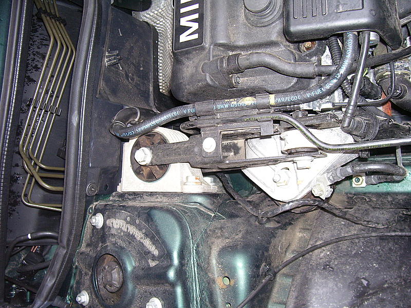

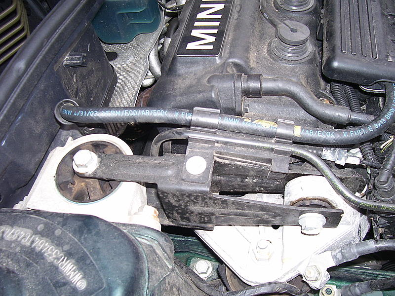

I have a 2004 MC bone stock that I bought second hand a month ago and I looked in the engine bay to see the spot where I would attach an engine damper and I found this. It looks pretty complex for an engine mount. Can anyone tell me what it is?
Murph
