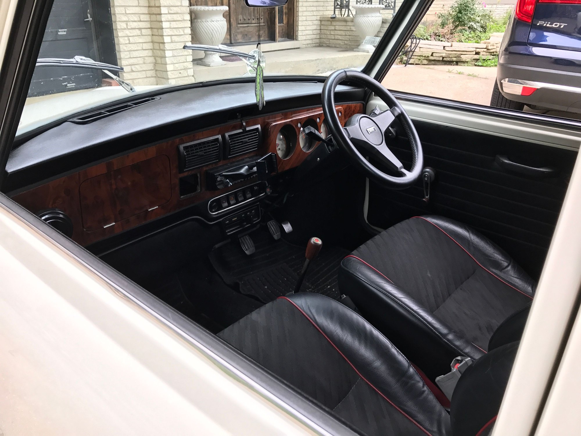

Hey all just finally picked up a classic mini. 92 Rover Mini from Japan right side driver 1275CC fuel injected. Got problem with right side door lock the spring sometimes does not push pin back enough and have to manually move it to lock it in. Anyway know if you can rebuilt it or have to replace? Been looking around hard to find in states. Thanks Mike

nice and very tidy mini.......as for the lock if you remove the handles and the door card you will see the way the mini door latch works sometimes when a respray or door skins are replaced the clips in the latch are not pushed home correctly
