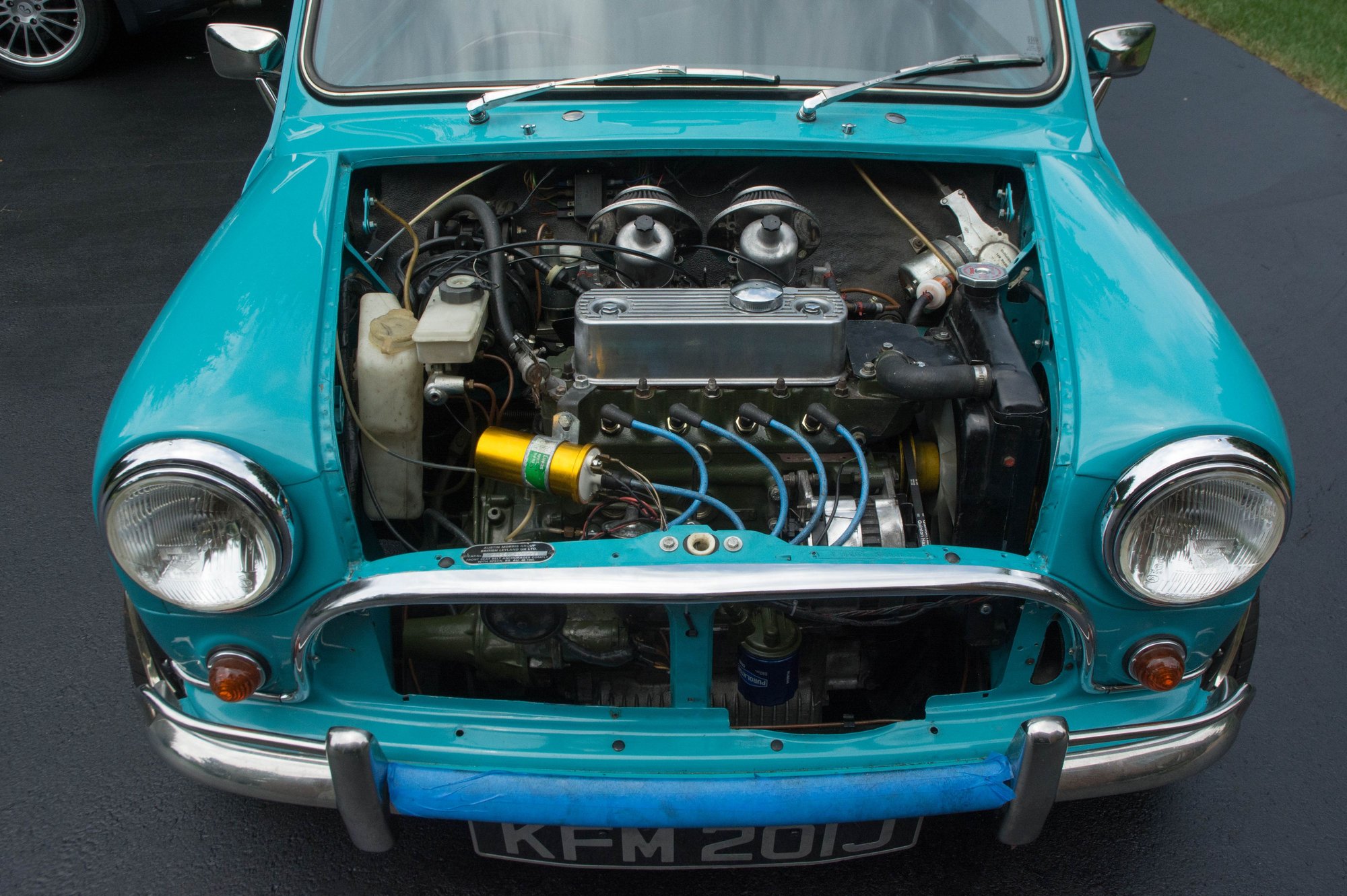

Hi all,
I have a mini with the 1275 engine, and dual HS4 carbs.
We are having such a hard time getting it to run properly, and we have tried so many things:
Did the "lite" rebuild kit on the carbs, cleaned up everything. New jet, new springs, float, etc
All new gaskets, both on the carb side and heatsheild side, new exhaust manifold gasket
Took apart head, cleaned all carbon, changed the seals around the valves, new head gasket of course
Valve clearances are set to spec in haynes manual
Timing is set to spec
New plugs
Now, i followed what i read online and turned the mixture nuts all the way tight, then back down 2 turns. It also says to do this in Haynes manual.
The problem is the car won't idle, and when i hit the throttle it either does nothing, dies, or it shoots up. The idle is sporatic and goes from 2-4k over and over.
Also, something i noticed is that the pistons on the carbs don't go up equally, and that also the LEFT carb's piston is always lower than the right side, i also noticed that the left carb has far less suction.
I tried disconnecting the linkage and turning the idle screws, using the uni-syn thing but it never seems to do anything at all.
I'm really confused, have no idea what to do next... any ideas?
