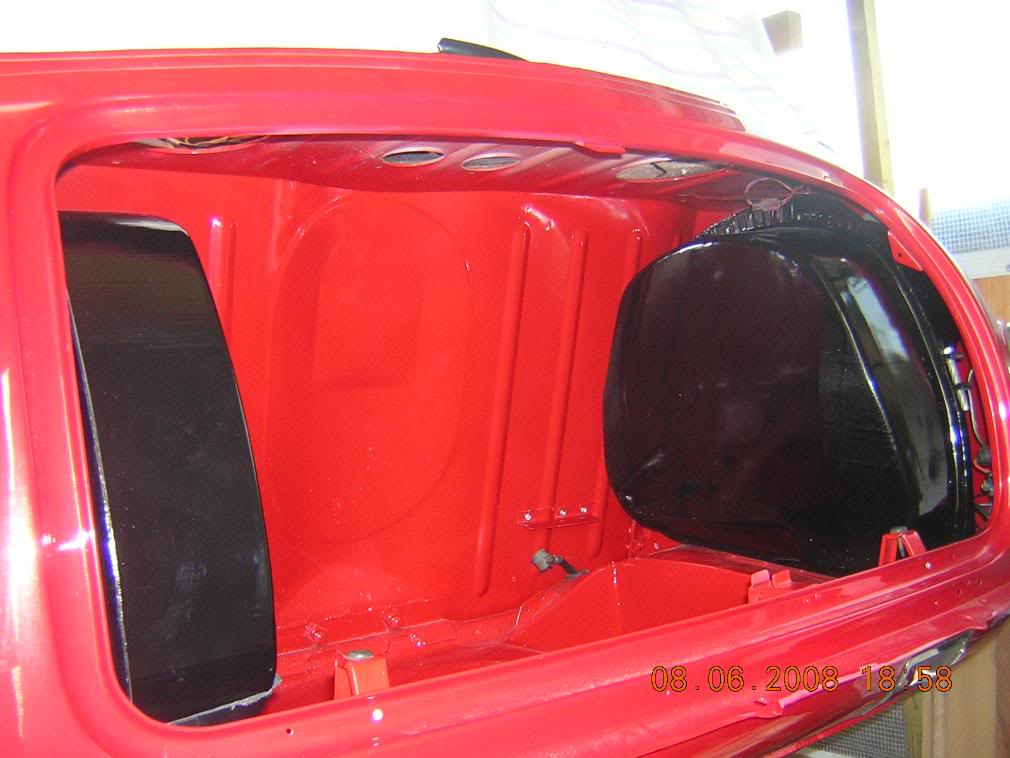

I'm not a fan of the right side filler cap - seeing as there isn't the right side fuel tank that it should be filling.

It turns out that fuel cap is for an additional tank. not sure if it was removed or?

The second tank was just a mirror image of the first one, so it's clearly not there now, even if it once was. Most classic fuel caps fit on the tank filler tube, not the body, so having the cap without the tank suggests to me that the second filler cap is decoration, not functional. A glance inside the that corner of the trunk/boot will show if there is a hole for a filler tube in the body.

You can purchase this dummy R/H tank filler neck to make it look like the car has twin tanks.......
this is a genuine R/H tank installed into My rover cooper......

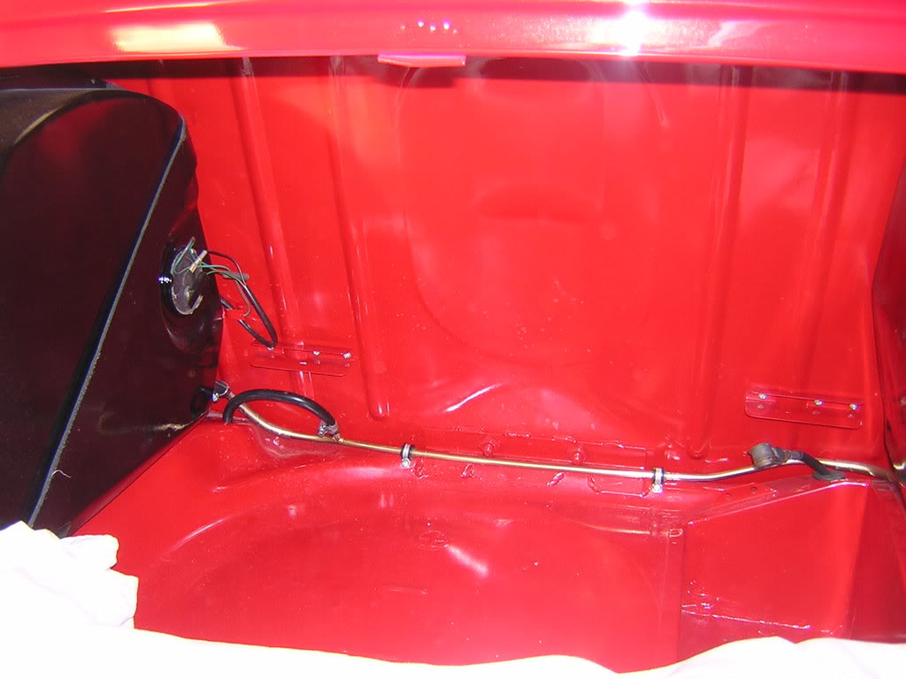

link pipe installed....
