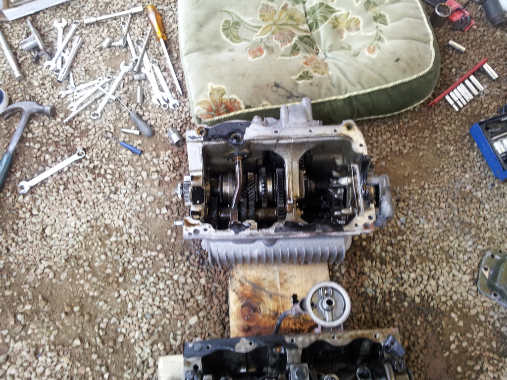

and start the strip down.....

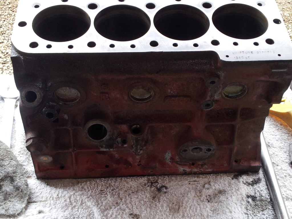

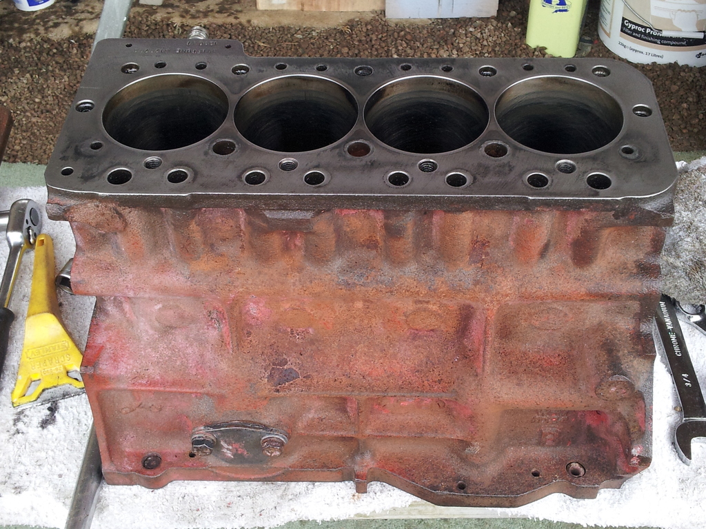

more done today.....block degreased and washout.....

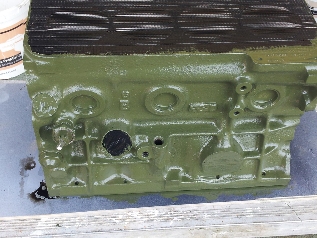

masked off and applied 2 coats engine enamel...............
Block done

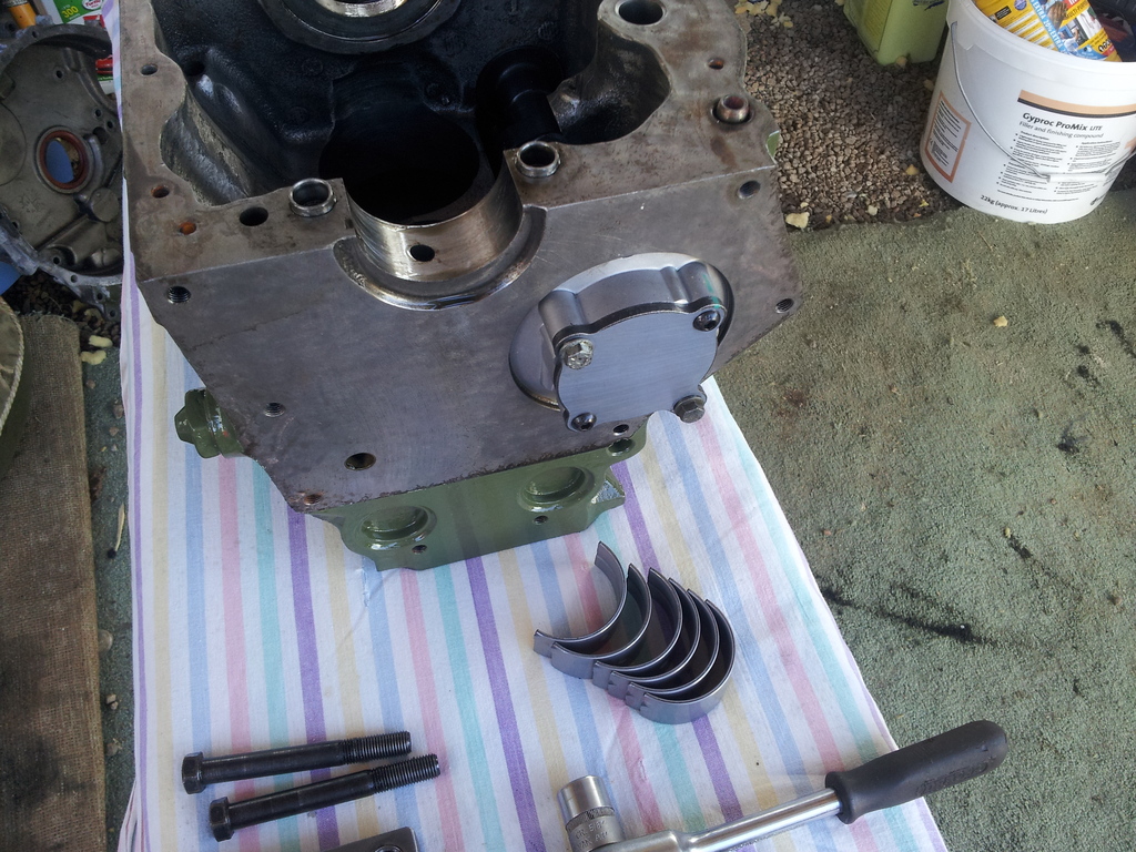

Bearings finally arrived from MED and started the rebuild..........New Swiftune oil pump fitted......
New SW8 cam installed.............
new bearings fitted to mains journels and crankshaft fitted..............

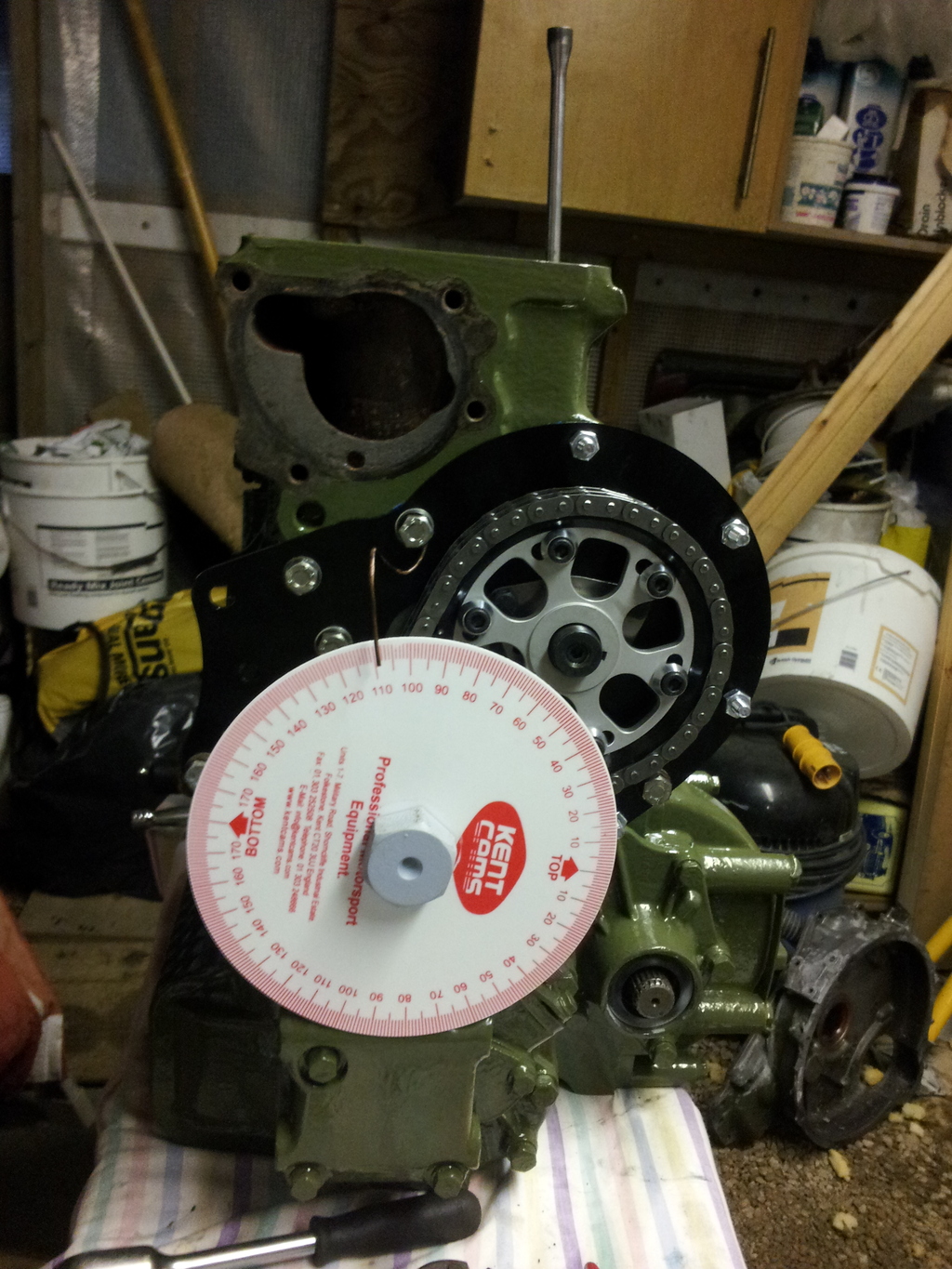

Fitted pistons and New MED Ally timing plate......
then mounted G/box to block......
and then set timing up.......
cam timed in............

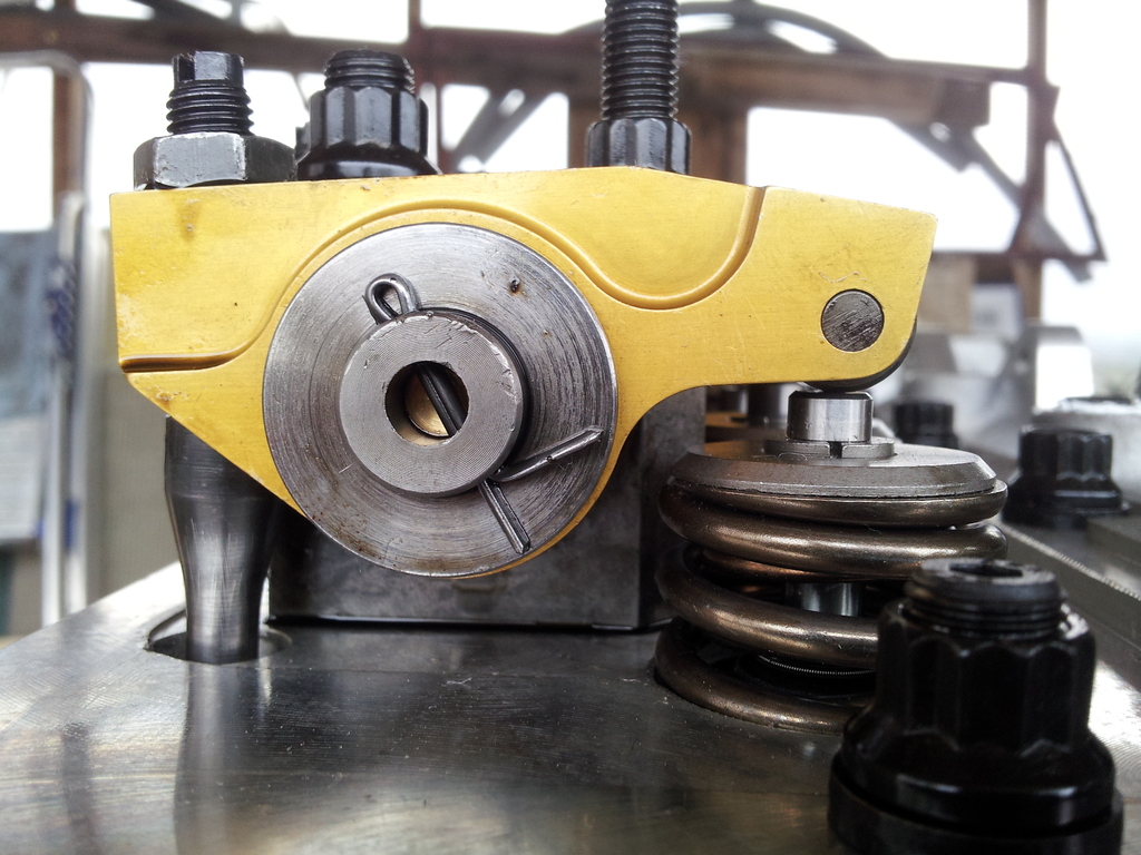

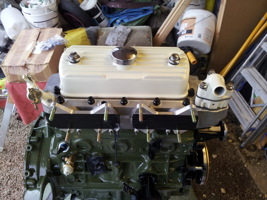

Hi..Fitted new 7 port head to block with New MED pushrods and fitted rockershaft and torqued head down set valve gaps............
also fitted water tap, thermostat housing, water pump, rovker cover.........
just awaiting new verto flywheel center as dumped old fly....lol

then fitted air box.......
Old Apr 18, 2015 | 07:07 PM
TooFPaste39's Avatar
TooFPaste39
Joined: Apr 2008
Posts: 61
From: NYC / Arkansas
Wow! That motor looks great.
Old Apr 19, 2015 | 11:59 AM
mk1leg's Avatar
mk1leg
Joined: Sep 2008
Posts: 623
From: Jersey C.I. UK
Thanks......
Old Apr 19, 2015 | 04:39 PM
v10climber's Avatar
v10climber
Joined: May 2013
Posts: 1,394
Likes: 19
From: FL
That's an interesting air box/filter setup.
I do really like the color you've painted the VC/Thermostat housing/heater valve. Is that actual paint or powdercoat?
Old Apr 20, 2015 | 02:14 PM
mk1leg's Avatar
mk1leg
Joined: Sep 2008
Posts: 623
the air box was designed to fit in a round nose mini with little body mods to bonnet and front panel........and the stat cover and rocker cover and tap are sprayed by me.......
All times are GMT -7. The time now is 11:44 PM.
