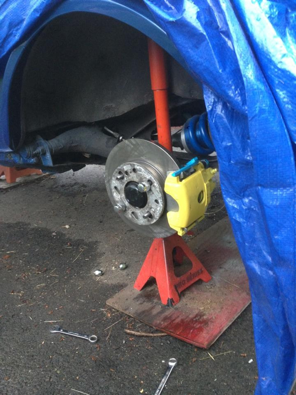

i had to ditch my rear drums, they were beat to hell, but i messed around and made some custom brackets to run 1980 vw 9.4 disks with pads and FRONT vw 1980 calipers and tapped in a hydraulic E-brake )) the power is unbelievable!! running 12 rims
