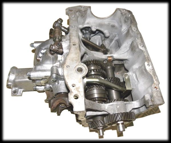

now is it a remote type box or a rod type box if the earlier type remote box then there s few ajustments you can do.......
there are two knuckle ajustments on the back of the remote box they could be worn see pic
