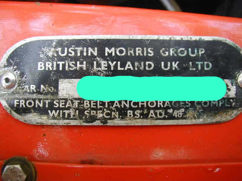

first off if you could inbed that picture rather than have it as an attachment it would show up larger and possibly we could help more. But it appears you've a good 'commission' number plate but on the other side where the 'chassis' plate would be is something of a shape I don't recognize; that's where I've always seen original number plates. All the "VIN" plates I've seen look something like this:
early ones say AUSTIN or MORRIS and later the AUSTIN MORRIS GROUP came into being. {Mine -79 - has been moved as the cross member where it was mounted was removed when the front end was replaced with glass but I have documents going well back b4 that which verify this chassis # including several years of MOT stickers}. MINISPORT sells replacements if you want to see a reference picture(s). Also an original plate will be stamped from the rear such that the number is raised on the sufrace, not engraved.
does this help???? not in discovering what the number is I guess

)first off if you could inbed that picture rather than have it as an attachment it would show up larger and possibly we could help more. But it appears you've a good 'commission' number plate but on the other side where the 'chassis' plate would be is something of a shape I don't recognize; that's where I've always seen original number plates. All the "VIN" plates I've seen look something like this:
