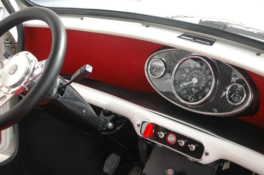

* What do the lights on the dashboard indicate (green one turns on sometimes even when I don't have the turn signal on)

2. Those gauges don't appear to be original equipment SMITH'S dials....on the other hand the lights on the speedo DO match the pattern I see both on mine and in the oldest owner's manual I have which is for a 1969. On a 69 the green light at the top is supposed to be for the turn signals; will flash and 'click' when a signal is operating and will quick flash if a bulb is burned out - or on some models, {checking various owner's manuals} the light may continuous burn if a bulb failed. If you are seeing it come on "at times" I'd start looking for a short in the turn signal wiring.... Welcome to the world of LUCAS
3. Now that's what the book says... And it also says the blue light is your high beam indicator, and the red is your ignition system failure warning and depending on the model the right amber is a low oil pressure warning or simply unused while the left amber is always unused....according to the books. However I find on mine the green indicates headlights are on and the two ambers are tied to left and right turn signals as appropriate and the red/blue function as the book says. That's how I got it. Point being, you may need to traces wires given we already suspect the dials themselves were changed so what was done to the wires at the same time? I KNOW my wiring harness has been modified and probably replaced entirely so I just mention as an example of what to expect as you begin to learn your car.

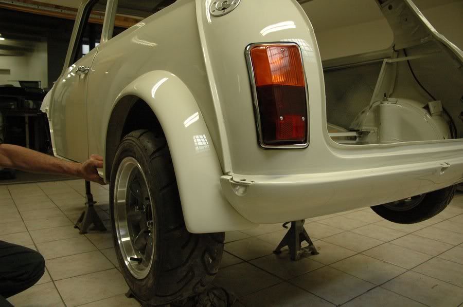

thats not a 1968 mk2 mini .....................
its got a mk3 shell......
the rear lights have a reverse light .....
the clocks should be black......
and and there should be external hinged doors with slidding glass.....
mk11 light cluster
black speedo
