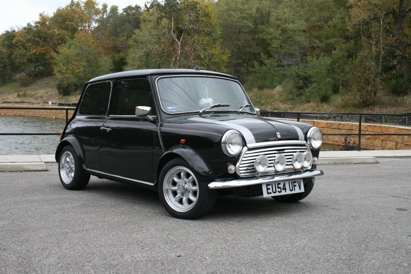

Well, I'm really considering a VTec Mini. I currently have an 89 Mini 30 with a 998cc motor and its just not enough juice. Here's my car now:
So heres where I'm stuck... My car is in great shape cosmetically and runs well.
