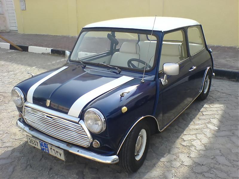

i think it is MKIV
& the engine 998cc
the engine is Very good & lately I change the electrical system by renewing some old cables & change the fuse box system by changing it from small box of old type fuses to modern one & larger fuse box - to give me more safety in the road
i'm increase engine cooling for the summer heat & i can't drive my mini in the summer @ 40+ C :impatient
this is an old photo ^^

The 4-core rad will fit straight in, very early Minis had a different rad bottom bracket but your car looks late enough for that not to be a problem. Use the bolted on black metal fan cowling from the existing rad. The 4-core rad is slightly thicker so you may have to remove the metal cowl box (spot-welded to the body) from the inner wing panel. This was not fitted to later Minis anyway. If you can see the inner wing panel next to the radiator (with large slots in to the wheelarch) then the cowl is already gone!
In an emergency an old trick is to put your heater valve/fan on for extra cooling! You will get hotter but the engine will get cooler as it brings an auxiliary rad & more water into use for the cooling system.
A spare mini heater rad matrix can be permantely plumbed in within the engine bay if you can find space to put it with some airflow.
If you have removed the thermostat make sure a special blanking sleeve has been fitted otherwise water flow around the engine gets messed up.
Hope this helps.
