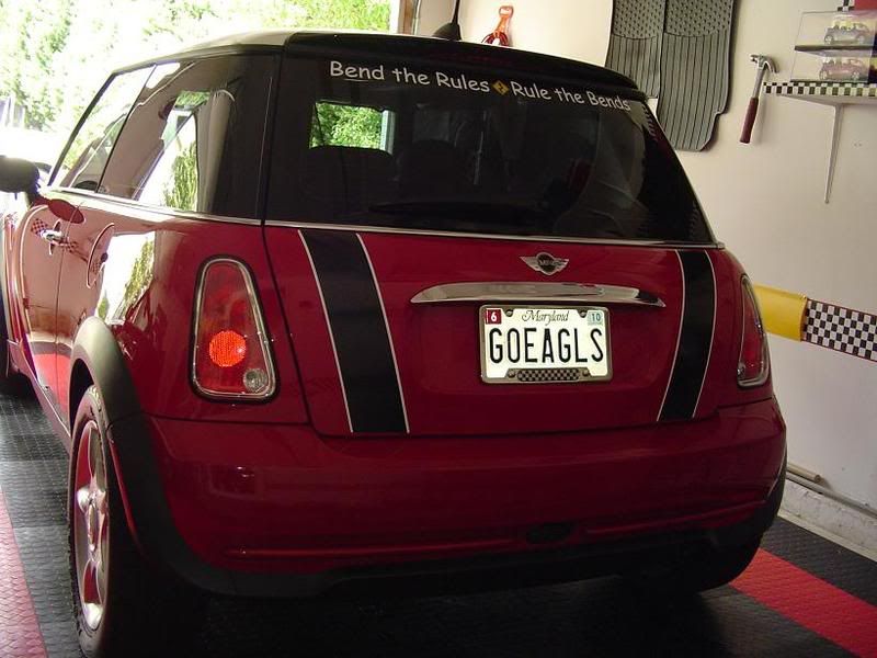

IMO, paying someone to install boot stripes is like paying someone to comb your hair. Do it yourself !!
See the stickied thread from ImagoX in the mod forum for easy dry-install instructions.
I've installed three sets and I can tell you, it's a 30-minute job... tops.
Just replaced my boot stripes on my CR Cooper last week. Dry install, as always.
