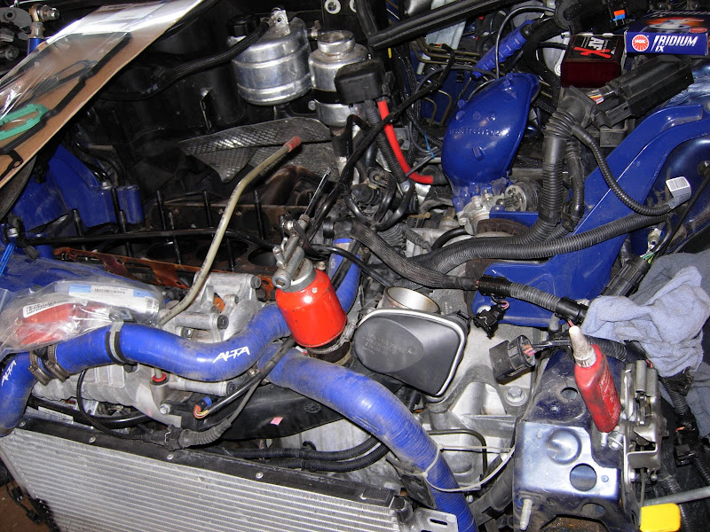

Holy cow!
What happened? That sure doesn't look like the typical pre-dragon oil and filter change

There are a few issues.
Rings lined up in #1, misfires and runs on 3 cyl.
Valve Guides worn. Was really bad in #3, cyl would fill with oil. Now before anyone starts thinking the guides are an issue in this head design let me slay that dragon. This was head #2 and the guides were OEM. There is also an 8k red line that I'm shy at bouncing off at the track. I've been know to track the car fairly often too.
Another issue was a bad MAP sensor, car would not idle well and would often stall when lifting off the throttle since there is a lightweight flywheel.
Of course a new mod is being added. Picked up an adapter for a spin on oil filter. With 28k miles and a fresh oil change from MINI I'm finished with the "free" services. Going to a spin on that uses a Honda sized filter makes it a lot easier to do routine changes.

The good news is that it sounds like you caught it all before it got really ugly. After seeing what you're having to do, my list seems sorta wimpy now

C'mon - what's the issue with oil filter placement? A 36mm Craftsman socket and a few turns, wait a few minutes to let the oil drain out (go get the new oil, uncap it, take the $#%@ foil cap off the oil, replace the oil plug in the pan) then put a paper towel under the oil filter housing and pull the housing. Last time I didn't even get a drip on the paper towel. This is perhaps the easiest and most mess-free oil change I've had to do on any of the cars I've owned.
