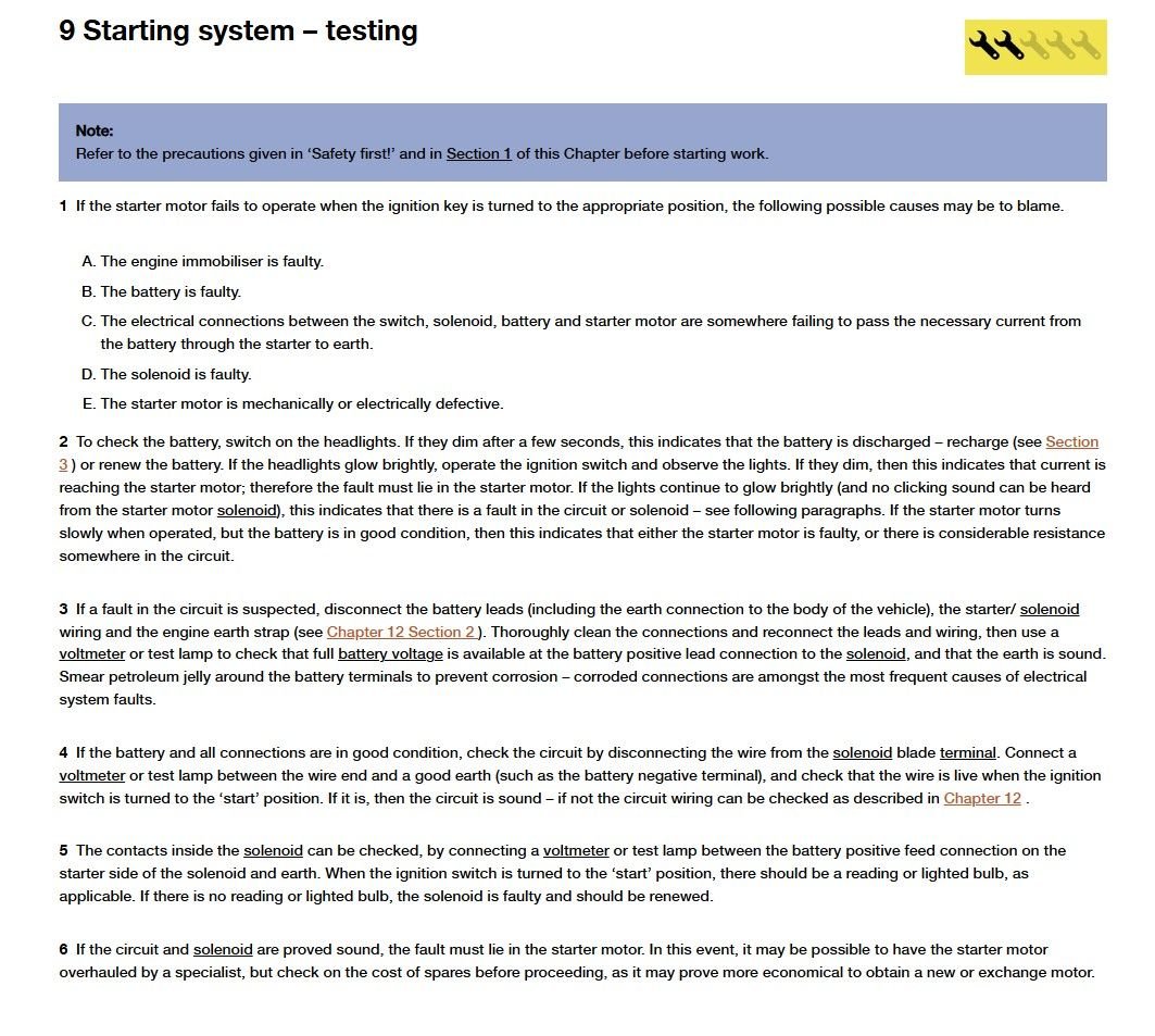

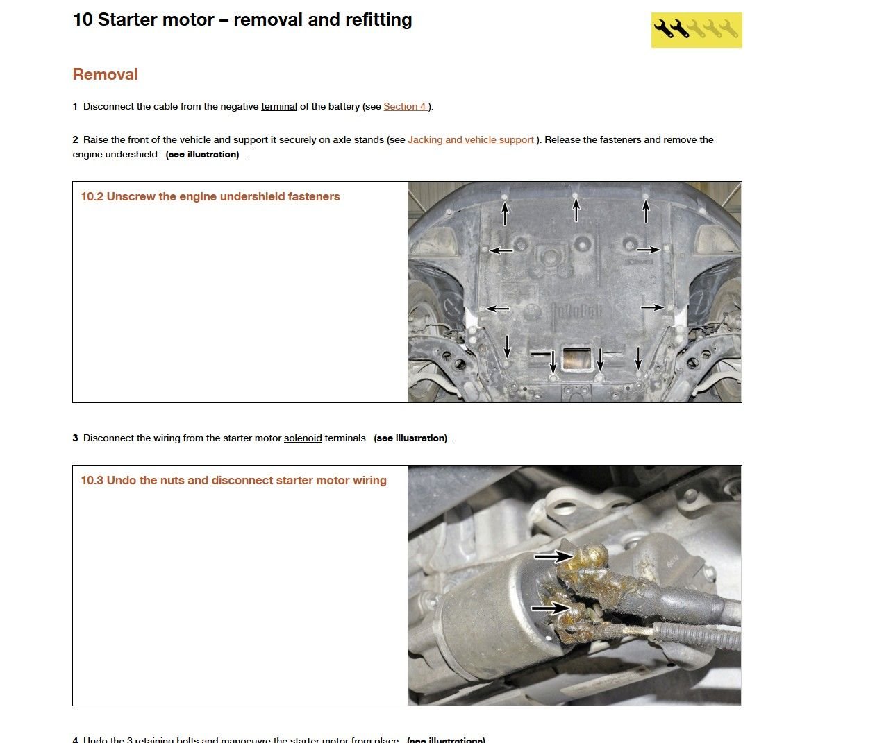

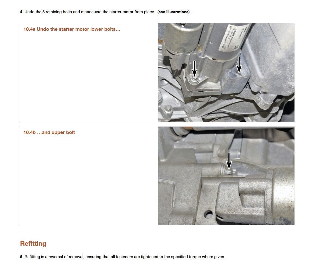

Does anyone know how to replace the starter motor on a Mini Cooper Countryman F60? I've searched extensively on YouTube and the internet but couldn't find anything about starter motor for F60
If you have any experience, pictures, or videos, please share them with me. Thank you.

it depends the model i think , but here are some photos it maybe helps you , better than nothing i believe
careful those star socket screws are very sensitive , find the proper socket before remove them , they can be stripped very easy , and then you will create more work for you
