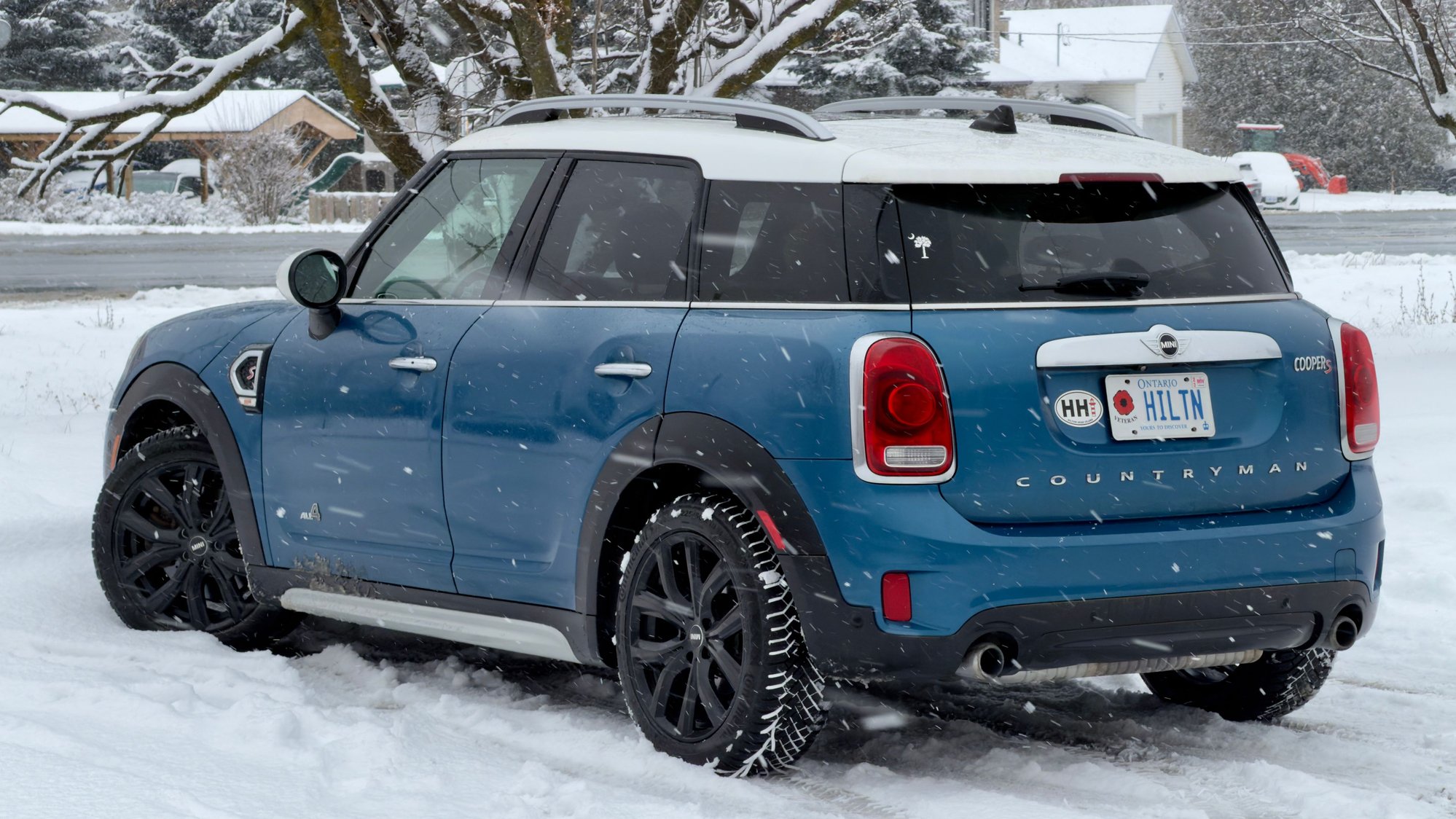

nice one mate , photo is good and full of snow proper conditions for the all4 .
dont know its my first experience with the bmw all4 , to be fair system differential underneath it looks quite robust !! compare to VW and for that age of car no leaks , drivewise i can't see anything important for moment , i haven't tried yet on snowy condition.
