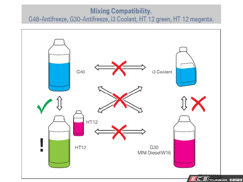

Hello,
MINI likes to change thing up on the Gen 3 MINIs. Most are Blue, but they have a new green HT12 (not the all fill green from the domestic side). Maybe someone changed it? If so i would just do a full flush. Or maybe its the green really thinned out and looks yellow?
https://www.northamericanmotoring.co...formation.html
