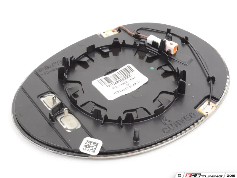

Yep i bet because the factory autodim (electrochromic) glass on the outside is so expensive, they just swapped in an regular glass. Pull that on off and you should have a set of wire single wires, one for heating and one for autodim.
