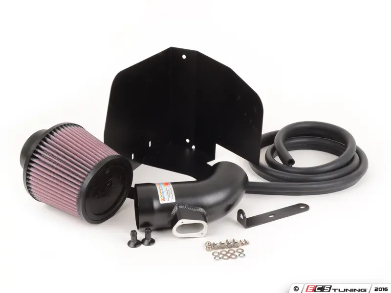

I have always trusted K&N so my question is this. On the K&N Website they list item #69-2026TTK as being compatible with the 1.5L Version of the 2019 F60, but no mention one way or the other of being compatible with the 2.0 All4s version? Can anyone confirm if this item will or wont work with my car? Has anyone mounted this intake system to their 2019 All4S? Love any real workd feedback. It looks like a nice tidy well built system. I just cant figure out if it is actually compatible with my car. Appreciate anyones input/feedback.
Old Sep 19, 2024 | 07:56 AM
Posts: 36,762
Likes: 2,551
It the MAF system you have to watch, MINI had two sensor designs. Make sure you have the
https://www.ecstuning.com/b-k-and-n-...9-2026ttk~knn/

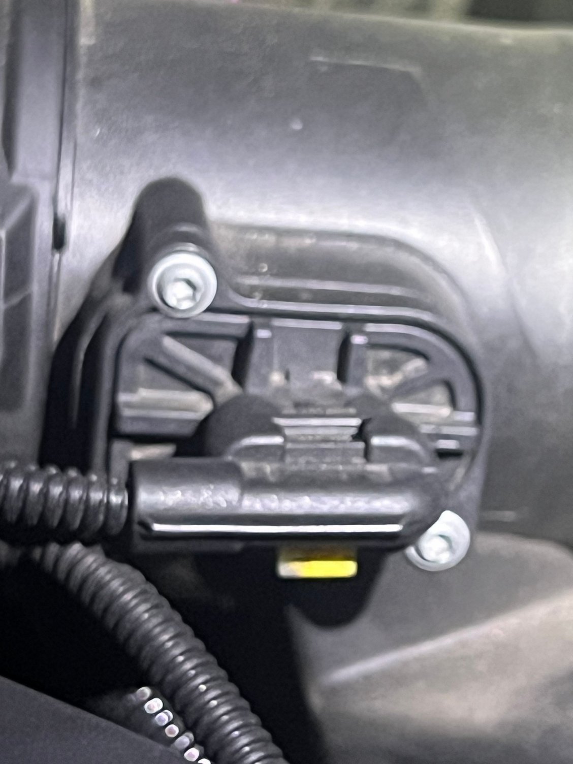

@ECS Tuning a photo of mine is attached. Is that definitive what style tube I need?
Hello, you are on the boarder year, to make sure, pop the hood and check that MAF sensor that is right on the intake tube on the driver side.
Old Dec 4, 2024 | 06:25 AM

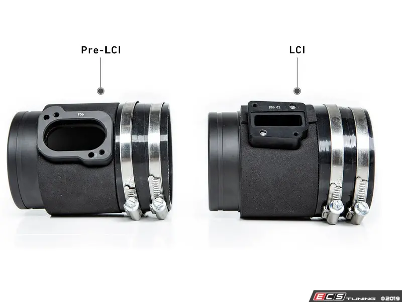

Posts: 36,762
Likes: 2,551
Hello,
You are pre LCI. So that K&N is correct above linked.
Here is another picture that helps.
PRE LCI Left / LCI Right
