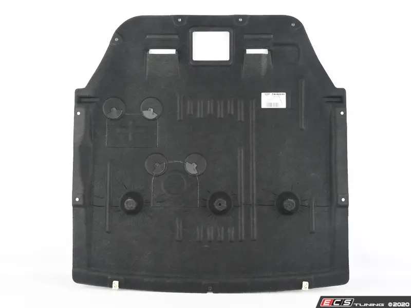

Here is the piece on the F60
Diagram: https://www.realoem.com/bmw/enUS/sho...diagId=11_5511
https://www.ecstuning.com/b-genuine-...o/11658605502/
Thats the acutal belly pan
https://www.ecstuning.com/b-genuine-...d/51757402947/

It's the air discharge duct for the turbo, all B48 engines have this underneath. Mine kind of hangs a little lower thru the belly pan.
MINI COOPER S TURBOCHARGER HEAT SHIELD AIR DUCT B46 B48

Yep, seems like these are common for damage, the thing is this takes heat away from the turbo. You dont want to cut that off or restrict it.

I agree...that open rubber part protruding out into the under-car air-stream will help pull air through the structure above, which helps cooling. Physics is cool like that B-)
