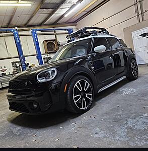

Lowered, on BCRacing coilovers.
Got the coilovers from @ECS Tuning , they did great on this setup with the Swift springs upgrade.
I will be placing the order for lower control arms this week as we could not get the camber right on stock.
New wheels are next to get the look we are going for. This is my wife's car, her daily driver. So I have to move methodically.
I removed the 17.5mm spacers I had on the rear, while I sort the alignment. May add them back afterwards.

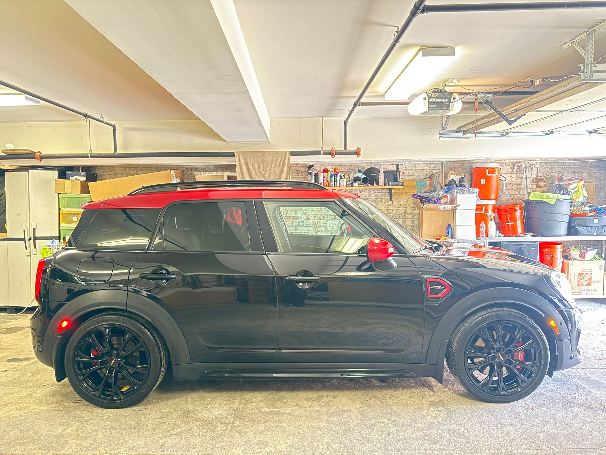

I got lucky and a local MINI enthusiast in the area had the NM Engineering 25mm Rear Sway Bar and the CravenSpeed Big Brace Kit for sale still NEW in their boxes. I installed these on top of the lowering springs and the handling is very improved especially in the corners.
Attached Thumbnails Lowering Springs-img_5723.jpg   Lowering Springs-img_5721.jpeg

Did you happen to add the chassis braces at the same time as the rear sway bar? I'd like to do springs and rear sway bar, but was also thinking about the chassis braces, but not sure how much stiffness and feel they will add on their own...

I did not add the chassis braces at the same time as the sway bar because it required 2 more additional bolts to secure properly so I did those later. To be honest, I don’t feel the braces provided any significant extra handling characteristics on top of the neuspeed sway bar. I’m sure there might be noticeable difference if using the factory sway bar but in my case, nothing that I was able to feel.
