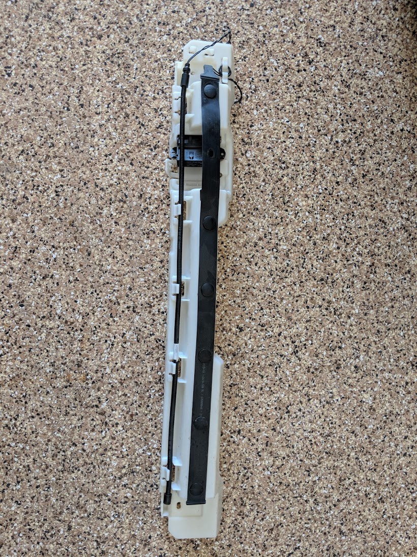

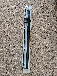

My wife is so incredibly pissed off at the automatic tailgate that she is pretty much done with the MINI brand. We've taken it back in several times, spend hours and hours at the dealership, and every time we get the car back it's even worse.
I'm about to embark on a physical fix, hopefully there is a connector on the sensor bar otherwise I'm going to start cutting wires (thanks miniminic for posting the picture). Not how I wanted to spend my Sunday with a brand new car.
Old Apr 22, 2018 | 08:58 AM
Miniminic's Avatar
Miniminic
Joined: Mar 2016
Posts: 181
I totally understand you. But don’t cut anything. You can let them code tye foot sensor out if you really don’t want it. Then you cannise the buttons on remote or car. Too bad they don’t get a real fix!
Old Apr 22, 2018 | 09:32 AM
gtmotor's Avatar
gtmotor
Joined: Mar 2014
Posts: 134
They told us they couldn't code the foot sensor out and that we'd just have to live with it. The problem is we have a baby in diapers still so when my wife is trying to change her in the back of the boot the tailgate starts closing almost everytime like clockwork. Reaching up to stop the tailgate with a dirty diaper in hand (thus smearing poop all over the inside of the tailgate) was the final straw for her.
That being said... I just removed the entire sensor without any difficulty. It unbolted and unplugged quite easily. So if anyone else is having trouble with their sensor you can just physically remove it until MINI comes up with an actual fix.
I just verified that every other way to open/close the boot still works (key, button, and interior switch).
