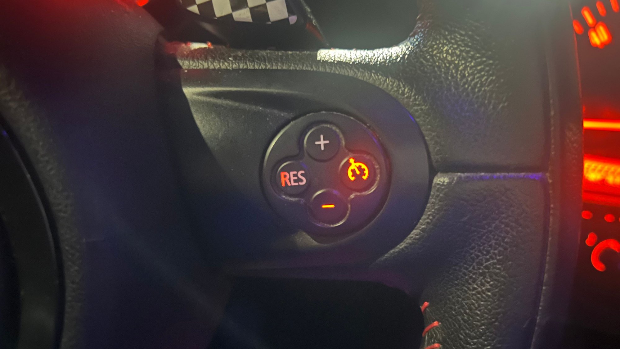

How do I fix backlight issue of the buttons on the steering wheel
As shown the photo, the backlight for some of the cruise control buttons is no longer working. I know this is not really an issue but wonder if it can be fixed myself? If yes, what's the part number and is there any YouTube video I can follow? Thanks in advance!

The switch is illuminated by backlight LEDs. If you know how to remove and replace surface mount LEDs and components, I imagine you could pull it apart and repair it. Otherwise, you’ll have to replace the switch assembly.

Sold in pairs and yep has a built in LED

Both have LED built in, or only ES#2590704 has?

The first product in that link is only the touch pad cover, not the whole assembly. You would need the whole assembly, the second product in that link, to fix the dim illumination issue.

Yep its the hole thing with wire and they both have leds on the left and right side.
The touch pads circles themselves are just the fronts that tend to wear down due to wear and tear.
