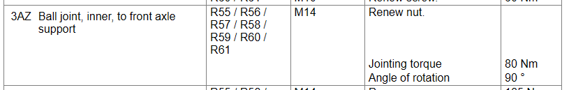

I had to replace the front lower control arm on my 2012 R60, and I am not sure of the proper torque for the 12-point 18mm nut on the inner ball joint that attaches to the subframe?

Old Jul 22, 2025 | 11:29 AM
BRGCountryman's Avatar
BRGCountryman
Joined: Jul 2021
Posts: 7
Great, thank you!
