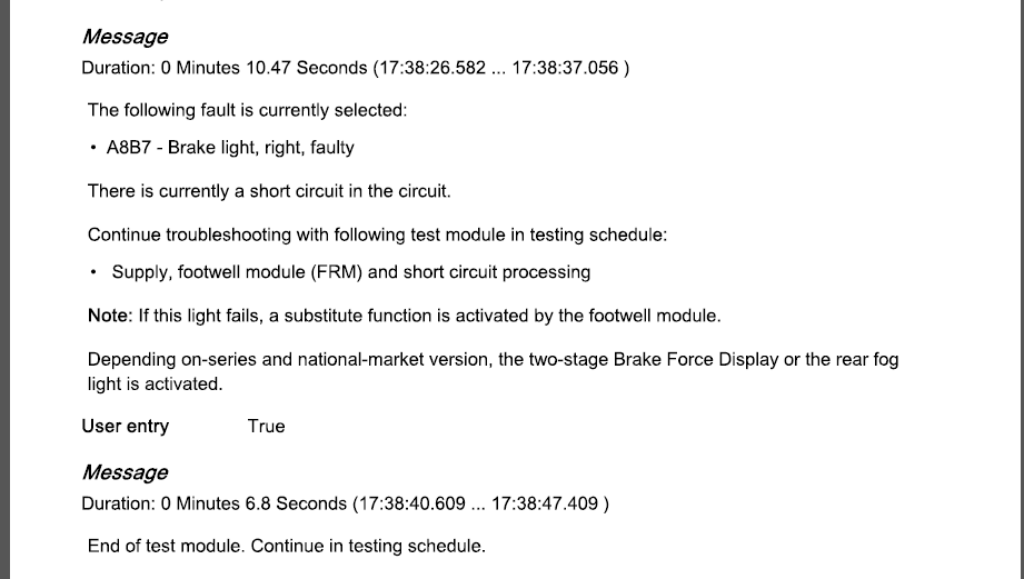

I spent several hours troubleshooting a similar problem. Using traditional methods (visual observation and multimeter), I concluded the socket wasn't getting voltage sent to it from the FRM module. It wasn't until I ran a diagnostics session using ISTA that I learned the FRM saw "too many" shorts on that socket and it turned off power to that 1 bulb. Clearing the fault wasn't enough, I had to run a job in ISTA that reset that particular circuit... then the bulb worked just fine. Well, at least I know the contacts are clean now!
