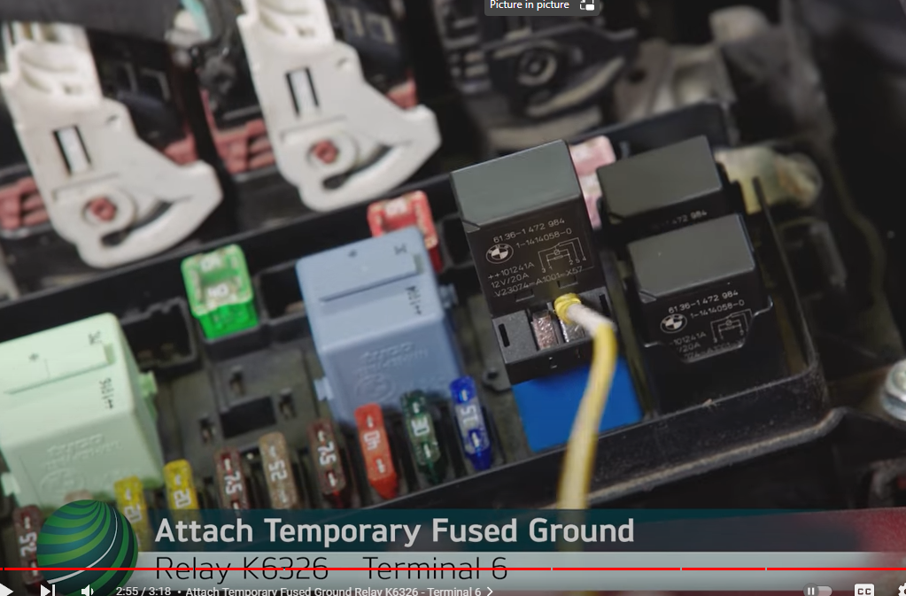

hello i have a 2012 countryman r60 with no power at coils (no engine start) i have been working on the car now for weeks, i have researched and learned a lot but im confused from watching a video on youtube.
i understand everything hes doing but how can the pictures i took of the video be correct?
please look at pics
my confusion lies where he explains that there should be positive voltage at terminal 3 on start relay (pic attached)
then he says terminal 6 should show ground if jbe is working (pic attached)
look closely terminal 3 and terminal 6 are the same terminal???
been at this for a long time maybe im going crazy?
terminal 6
terminal 3

I may be mistaken, but I don't believe the R60 and the R56 have the same engine.
