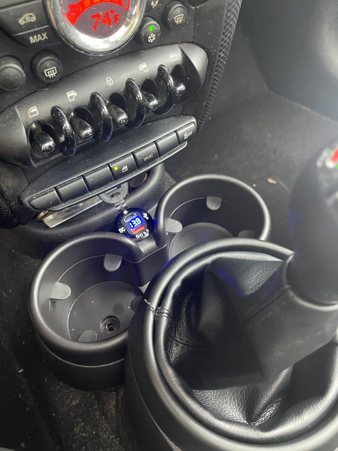

I ended up drilling out the hole a little bit where the cigarette lighter was and fit a usb and usb-c adapter there permanently, which also has a digital voltage meter. I made a pigtail wire to connect to the harness.
love it

I think you are legally required to post a photo.

well I don’t want to get in trouble with the law 😆
