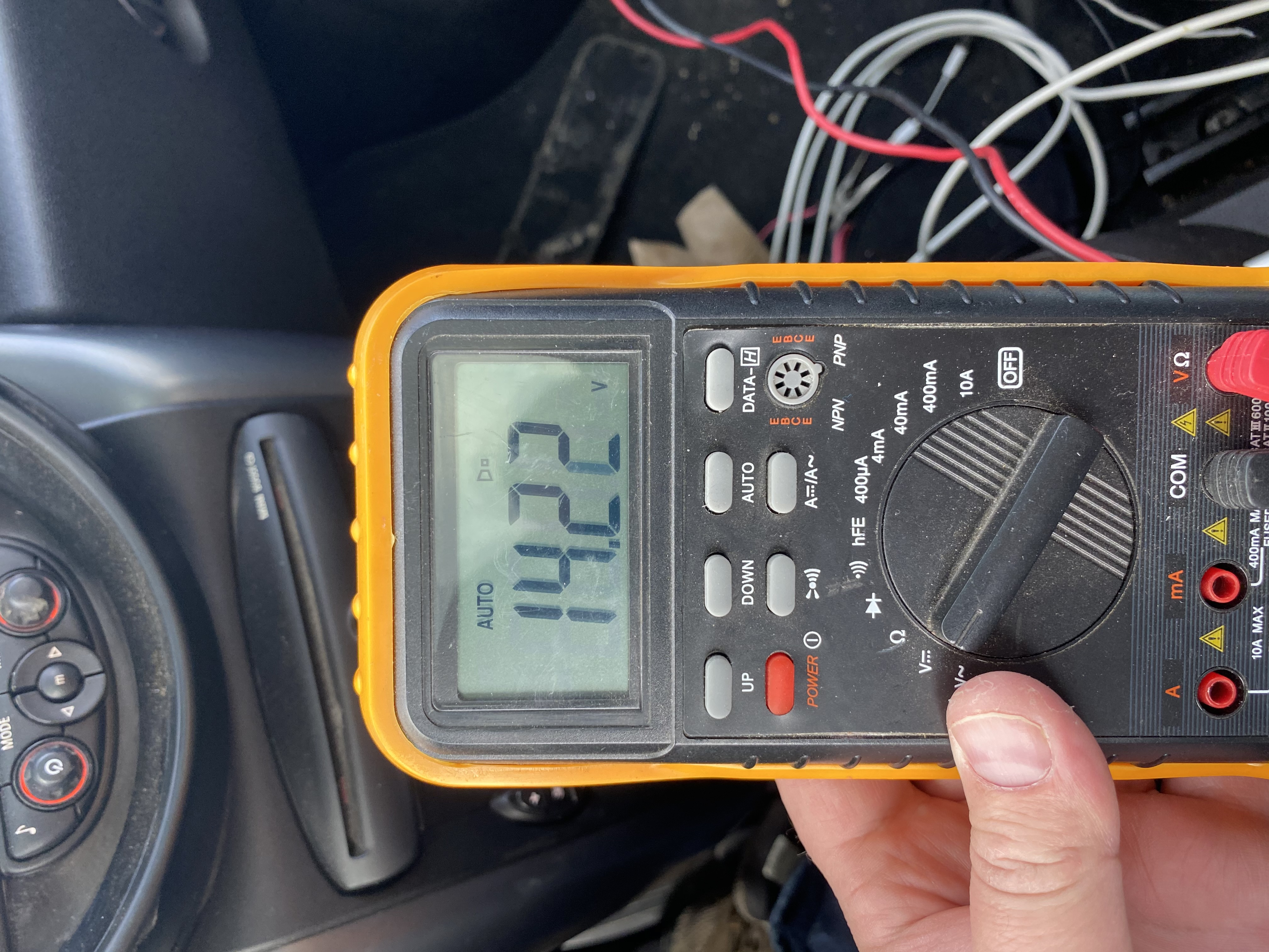

Hi, thanks for the reply!
There was an orange Battery light when this first happened. But after the alternator changeout, there has been nothing. In the incident, I described where I had the multimeter monitoring the voltage neither the red or the orange battery light were on.
I attached a pic of the voltage just after starting, ODB2 scan with no codes on it, and some videos showing the behavior of the locks and the dim headlight.
