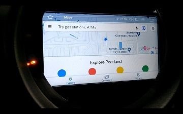

Thanks again zcspec for the great instructional (and motivational) video to help with my radio installation. You definitely weren't kidding about how challenging it was to access and remove all of the bolts! Whoever designed this dashboard should be fired! Here are some pics of the final installation and screenshots. I'm debating whether or not to create a new thread with more pics of the installation process.
OEM Mickey Mouse radio and CD player (L) and Seicane Android radio and CD/DVD player (R)
Seicane Android 10.0 user interface (L) and music video screenshot (R)
FM radio screenshot (L) and Google Maps screenshot (R)
YouTube streaming
License plate rear backup camera (L) and backup camera screenshot (R)
