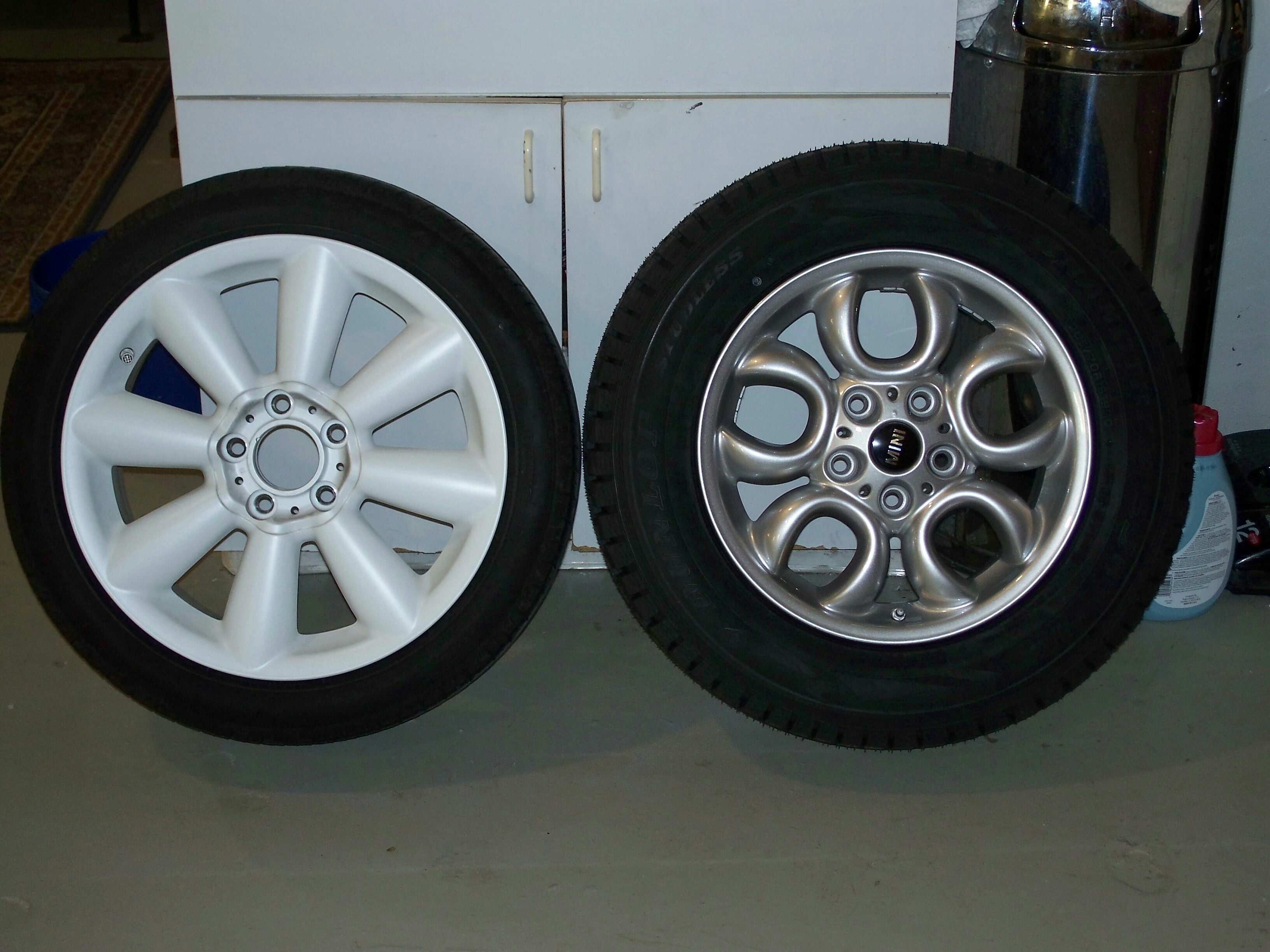

i bought 16x6.5 et 46 mini oem euro alloys from ecstuning dot com and run 205/70R16 dunlop grandtrek sj6 winters
they are 1.4 inches larger OD so i get a little more ground clearance and have a much taller sidewall for pothole survival
ecstuning also has mini oem steelies in the same size for about half the price of the alloys
