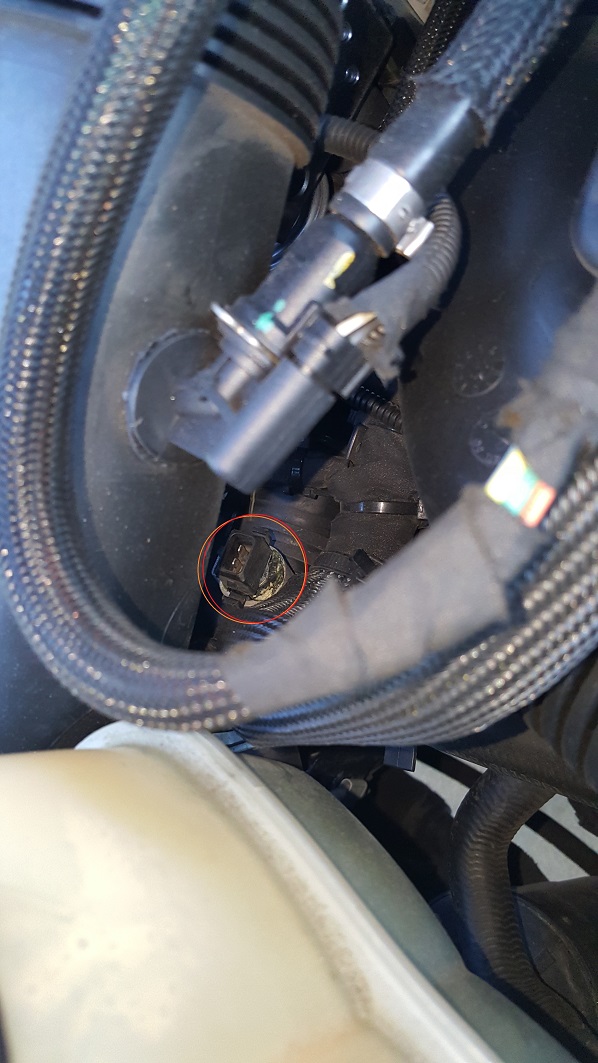

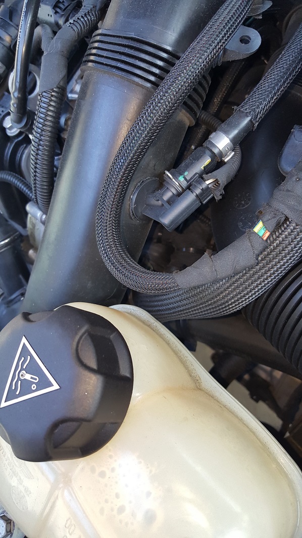

Hi there, today when I look inside the engine bay to check if any coolant or oil leak, I found this little plug. Is it supposed to connect to somewhere ? Does anyone know where this thing goes ?

I thought the same thing, but on the N18 motors it's supposed to look like that. You are fine.

Did you get your thermostat replace? That 'little plug' is the coolant temp sensor that is now relocated to the new tstat design. That error code is a symptom of tstat going bad and will need to be replaced. If you're under warranty, get it fix asap. If you're out of warranty, in CA, the tstat is covered under emission warranty for 7yrs/70k miles.
