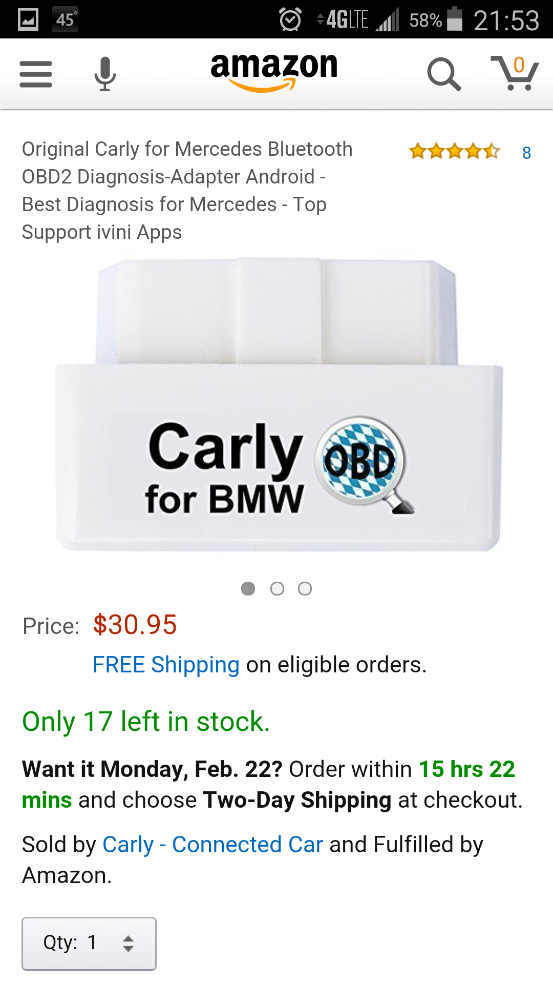

i searched amazon for "carly obd adapter"
Attached Thumbnails Position lights 2012 CMS-screenshot_2016-02-19-21-52-38.png   Position lights 2012 CMS-screenshot_2016-02-19-21-53-02.png

Looks like they are not selling a bmw version right now on Amazon. Any other recommendations? Thx
Old Feb 20, 2016 | 12:19 AM
bmwr606's Avatar
bmwr606
Joined: Feb 2012
Posts: 2,264
Likes: 31
From: wisconsin, usa
if you goto mycarly.com you can send them a message and they will put ine up on amazon ... when i bought mine, there were none up and they put it up same day
