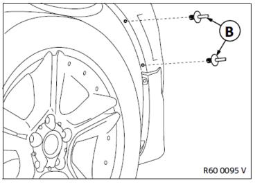

Attached is a link to a detail part site where you enter your model and see specifics parts.
To remove bumper you need to knock out atleast two of the expanding rivets on the rear of the wheel well (two on each side) next to the bumper. Partially pull away trim where the two rivets were removed to reveal the bumper fasteners and start removing bumper. I would recommend picking up atleast four expanding rivets (see link for part numbers), as you can punch them out with an awl or a nail but sometimes it is hard to find the little black plastic pin that falls out (B) that will be needed to reinstall it later.
