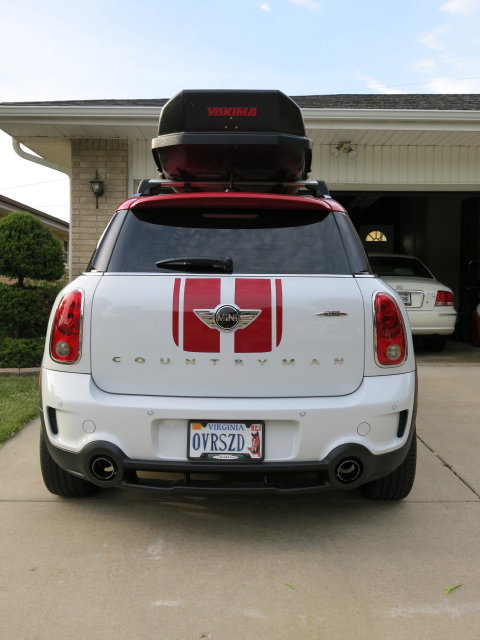

I just drove 830 miles one way with a Yakima Skybox 16. Box Outer Dimensions: 81 inches x 36 inches x 15 inches. Stubby antennae is a must or you will need to remove your OEM one. Opening the boot opens but is limited slightly by the rear spoiler. Gas mileage dropped about 1 mpg. No wind noise except when driving next to large semi.

I've got a Yakima Rocketbox Pro 14 on my CM. I pushed it back as far as it would go with the OEM antenna. You can't see it through the windshield--I'd say it sits about as far forward as TJANK's.
