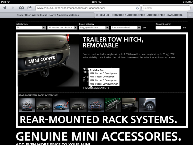

It looks like tree s one available or the Euro Countryman. Not see if it would fit the US model but it should be cleanest install and is rated 1200kg which is about 2500lbs.
