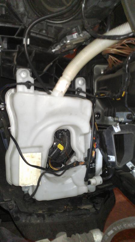

After missing the driveway ramp when backing up, the front end of the car hit the sidewalk. There was a leak at the front of the driver side wheel well.
This is not the first time my partner misses the driveway ramp, so I have "some" experience getting to the reservoir. I removed the wheel and liner. Then I removed the light connectors (side marker, parking light and fog light), tilted the reservoir, remove what it looks like a sensor on the left, then remove BOTH pumps (two) by tilting from the reservoir and pulling gently.
I checked the reservoir, there were no cracks. I installed everything back and so far no leaks.
I think the reservoir flexed with the impact, pushing one or both pumps out of place, they're hold by a grommet only. If this happen to you, check it first. The price of the reservoir online is about 90+shipping, and you may not need it.
