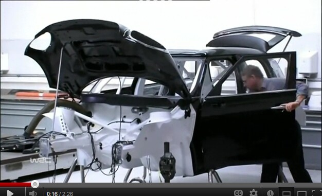

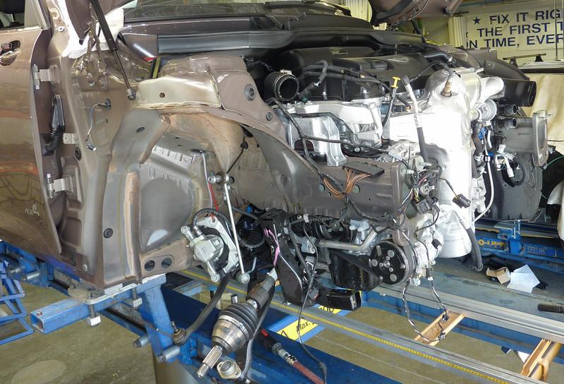

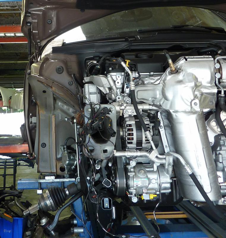

Looking at my CMS ALL4, I think we might be in better shape than, say, the BMW 3-series ("marginal"). Using the drawing of a MINI WRC car, it looks like the strong bits in the front, the two projections that go out to the bumper, may be widely enough positioned to contribute to protection in this situation, unlike the example VW shown in the article. The photos of the front end of my car show how these parts look.
Attached Thumbnails New IIHS Crash Test - Small Overlap Frontal-cmfrontend25percent.jpg   New IIHS Crash Test - Small Overlap Frontal-minicmsall4rtfront.jpg   New IIHS Crash Test - Small Overlap Frontal-minicmsall4rtcorner.jpg

The piece you're referring to is an extension of the sub-frame. It's not gonna help much. It's the frame that matters... the rails on which the motor mounts are bolted on each side.
The new crash test will have many once "safe" cars in the LOW LOW score territory. Originally, they crash tested at 40% of the front-end. Now about 20-25% of the front-end hits the wall and must absorb all that energy. And if the car misses the frame entirely and shears off the the wheel, the bulk of the energy will be absorbed at the A-frame.

I would argue that the two rails that stick out front, common among many new cars, are, with the engine stuff, what we've got to absorb some energy up front. Admittedly they're tied to the wall between the A frames, hopefully very strong. The stripped down WRC shows the important parts they left out front.
My point is that, unlike the VW with a relatively narrower spacing, the MINI CM may be able to engage those supports in the new test, to the benefit of the crash test score (and the "occupants").
I couldn't agree more about missing that structure - the wheel supports on the CM get stripped off and the A frame takes the hit, just like in the article photo.
Attached Thumbnails New IIHS Crash Test - Small Overlap Frontal-prodrivebarewrc.jpg
