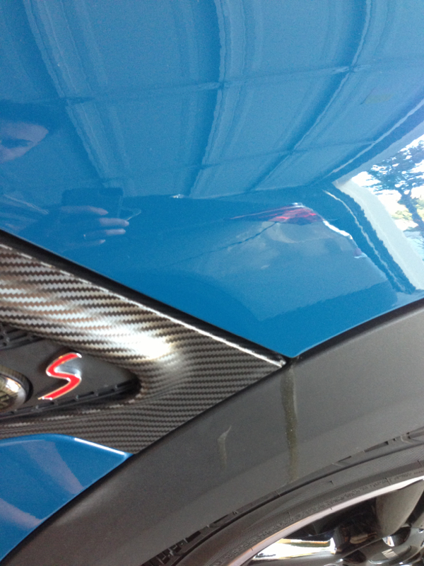

Thanks! Though my hesitation is I don't know it's cosmo dripping. My drip is right below the side scuttles, see pic. It could be the glue maybe?
Any suggestions on what I should use please?

That is DEFINITELY cosmoline!!! Look across your front bumper as well, you may find it seeping out from the corners of the grill. Take a q-tip and dab a little. Does it look a little yellow? That's cosmo. Pop your hood. You may find some leaking out of drain holes under the hood too.

Quick update - I was in at the dealer to get my JCW exhaust kit installed and mentioned the drip. The MA immediately identified the problem and said he'll get it cleaned up. And they did! Looks spotless now. Thanks for the advice on here
