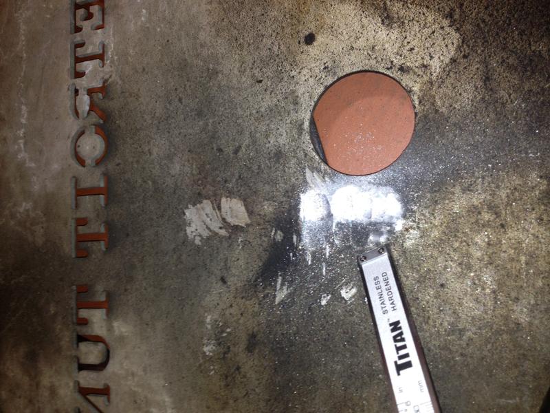

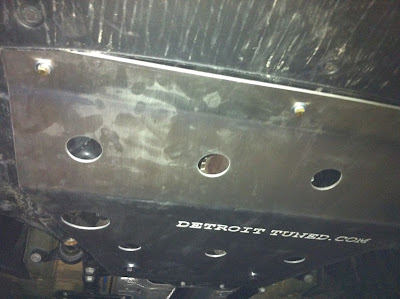

Adding extra clearance with skidplate
I heard some "clunk" sounds when accelerating and decelerating this past weekend. The dealership took a look and found some wear on the exhaust flex pipe where it has been contacting the Detroit Tuned skidplate. We're adding some spacing to provide clearance where it wasn't previously needed.

We have found that every car is built a bit different and we have made the spacers bigger than the last batch to give more clearance. I also find that every tech that ever has to take it off throws them out and doesn't reinstall them....but due to so many different cars and how it is built, it is very important that the installer makes sure that there is enough room between the plate and any moving parts so that there is no rubbing like it says in the directions.
