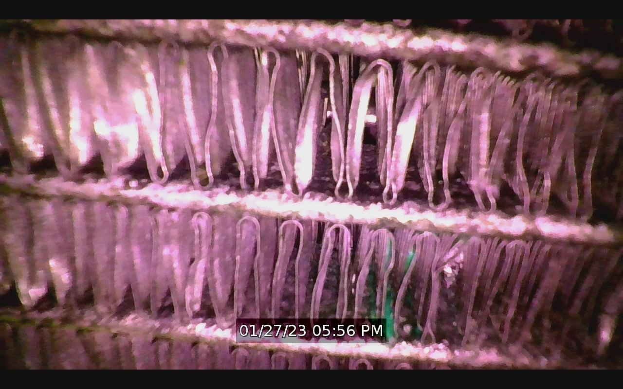

Thanks for your hospitality. We just purchased the R56 as a dingy for our Sprinter Van. It is presently a winter project. At 138k miles it's getting a chain and tensioner...regardless.
Found a pin hole in the A/C condenser:
Condenser pin hole located by utilizing fluorescent dye and the UV function of a Fluke DS701 videoscope.

Welcome. Thats great you found that, Sometimes those are hard to find, i have seen them on the end tank connections.
