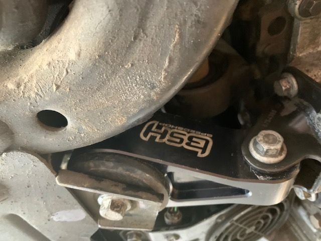

The journey of a thousand miles starts with a single step
The place we all know so well, front end service mode...
Purchased a few things from @chriscummins0
OEM lower motor mount out
BSH motor mount in - yes, it is upside down but seems to be the same dimensions either way you flip it. I can only assume this will cause the car to burst into flames. "Jerry didn't you know about the well documented failure mode associated with an upside down BSH logo...?"
OEM upper motor mount on it's way out...
Then a terrible surprise... I mean, how did the previous owner even accomplish such a thing?
Also this... how??!?!?!
Vibra-technics upper mount in

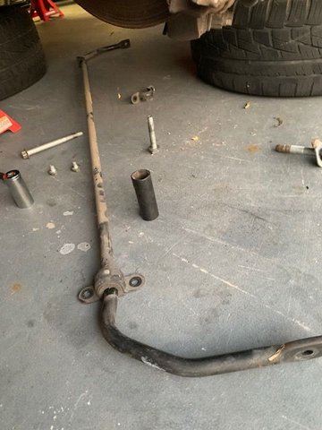

Small steps
Installed a new rear sway bar. Purchased from @WayMotorWorks
Removing the rear shocks...
OEM sway bar (17mm?) out...
Hollow 25mm sway bar
Brain: initially put the sway bar on a soft setting until you're used to how it handles
Ego: go super stiff bro...
Brain: you're not a very good driver...
Ego: stiffer than Jeff Bezos in a helicopter flying over the Seattle space needle
Brain: idiot
And the real reason we buy performance parts for our cars.... stickers!

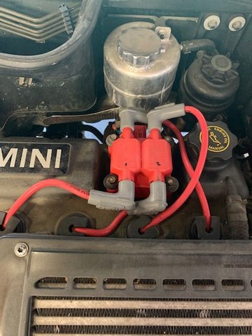

Ignition stuff
Purchased components from @MiniManAdam
Getting out the old stuff
Crusty...
New(ish) stuff
Plugged in...

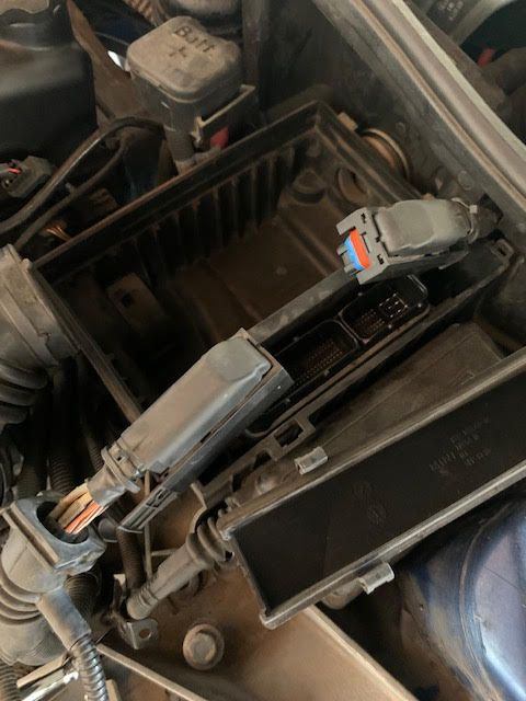

Installed poly inserts into the transmission mount. Purchased from @WayMotorWorks
Top of the airbox taken off. Starting to take out the 4 bolts that hold in the top bracket
ECU disconnected, allowing me to pull out lower air box and expose last bolt to take off top mount bracket
Inserts pushed in
Installed - a beautiful yellow contrast against the dirt and grime
Brain: idiot
Please be careful on full stiff setting that you put your new 25mm bar on! Even at full soft it is 226% stiffer than stock. Your bar is currently set at 383% stiffer than stock!
