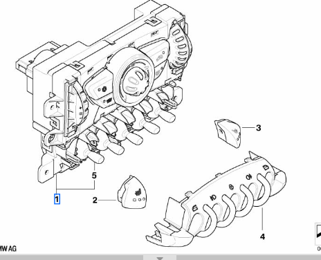

Took me a while and working with several Mini parts dealers (that sure wasn't fun) but found what needs to be replaced. Sadly it isn't just the control ****, it is the entire assemble. Here is the part number and what the dealer quoted me (just for the part) and an image.
64-11-3-454-854 and $578.02
With that kind of price I will live with it. Maybe you will have better luck.

3D printing?
Mark,
Thanks so much for including that MINI part number….and of courrrrrrrrrse it’s the whole assembly! :(
You know, looking at the dial, I wonder if it’s a potential candidate for using 3D printing to create an “overlay” which would essentially give us a new dial without having to disrupt the existing mechanism?

The other option might be to look for this assembly at junk yards.
I was able to locate the second Boost CD assembly for my R56 for quite cheap and used a few of it's parts as replacements.
But first I would just look if you can remove the climate control panel and simply clean the ****.
