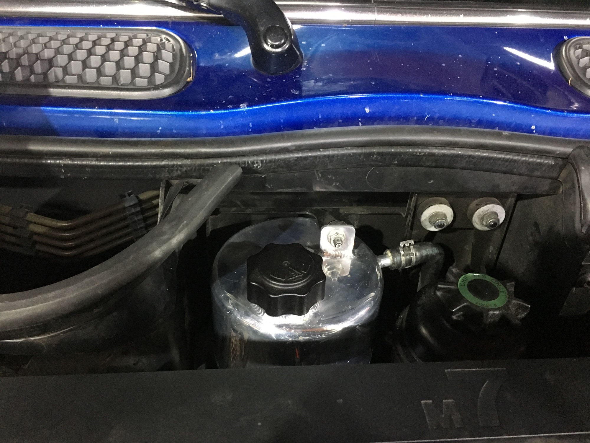

Does it still have the plastic coolant tank? If so, it is most likely split and causing more overheating, which is common with the R53.
Many of us choose to replace the tank with an aluminum tank, that takes the factory cap.
I feel it is best to buy a tank that takes the factory cap
