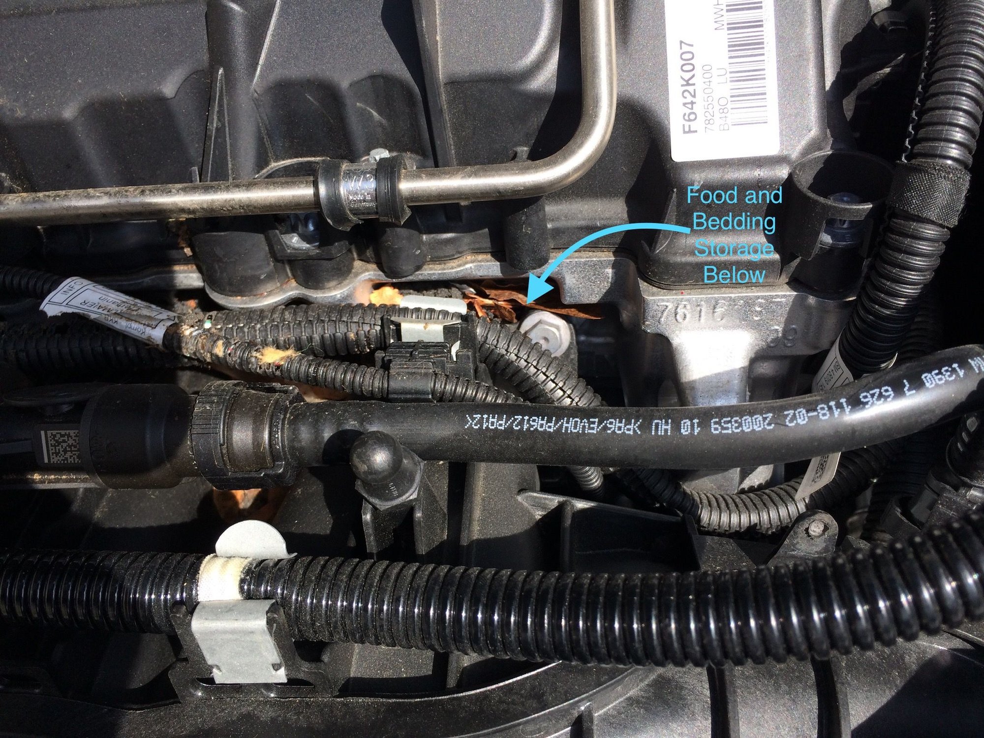

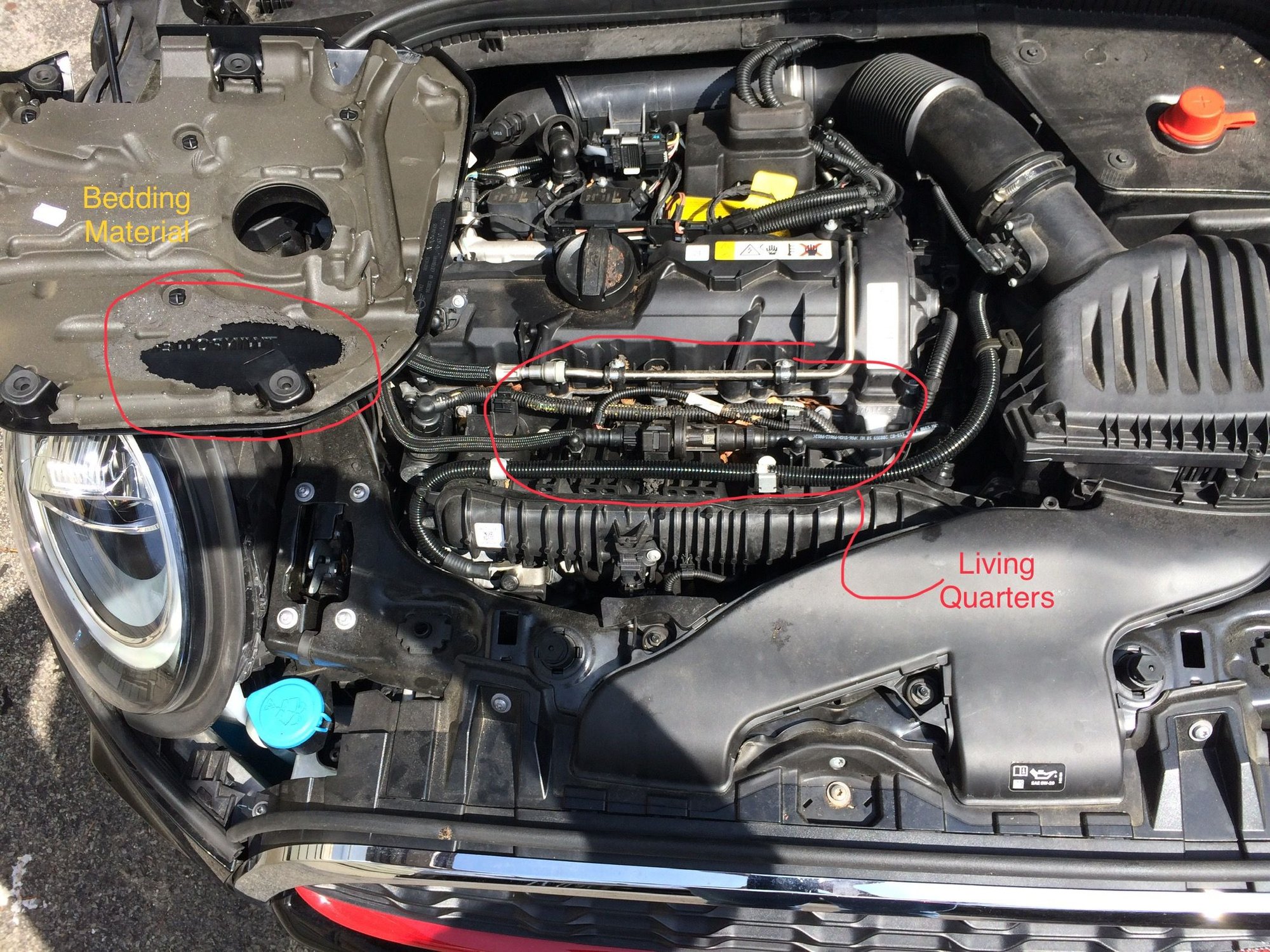

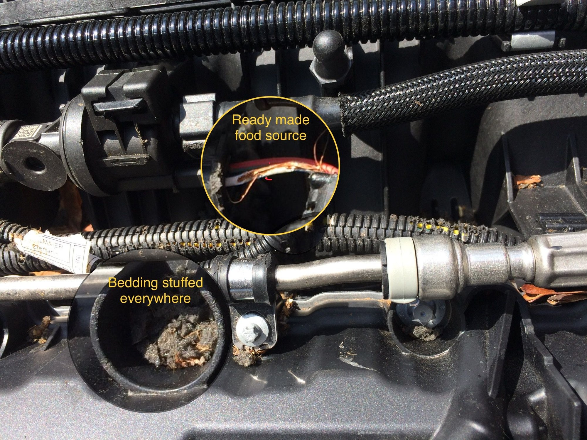

The MINI made mouse house
It turns out that MINi/BMW has created the world’s most perfect mouse house. What better place could a mouse want to live. Very well protected. Warm, at times. Plenty of available bedding. And tasty food all over the place and dental floss if you want... For a meager $30k +/- a little, depending on the deals MINI is offering, giving a mouse and their family, if they want, can live in MINI/BMW luxury, with a padded roof, plenty of family space and room to roam about. Just feast your eyes on these living quarters:
An insulated roof
Plenty of available bedding material and luxury living quarters.
Available food and storage space
More storage space

Thanks...
I am finding these days, humor is the only way to survive. I am surprised that MINI/BMW created such a mess. The engine is the BMW engine used elsewhere, so I expect there are some expensive Mouse house Bimmers out there...
I have had a few nests in the other MINIs over the years but no damage. Whatever it is, they love the air filter housings. Our R50’s air filter was so packed one time I was surprised it would run. This was the first one that was damaged. The dealer said that they could fix it, but my cost. I’ll have them do that. It could be squirrels, or chipmunks or mice. We have all 3 running around. Can’t do anything lethal. The feral cats, which are “pets” of neighbors, might get it or a critter with it and get it through them. We had a kitten kill last year that wasn’t well received. I have a few suggestions from friends that I will try. I may opt to leave the cover off. It is deadweight any way.
An odd thing about the chewed wire is that the way MINI routed it, the wire and its sheath has to bend 180 deg to plug into its receptacle. The sheath around the wire, which doesn’t like to bend, had pulled away exposing the insulated wire. I am going to ask the dealer to extend the wire when they splice in the new one so that doesn’t happen again.

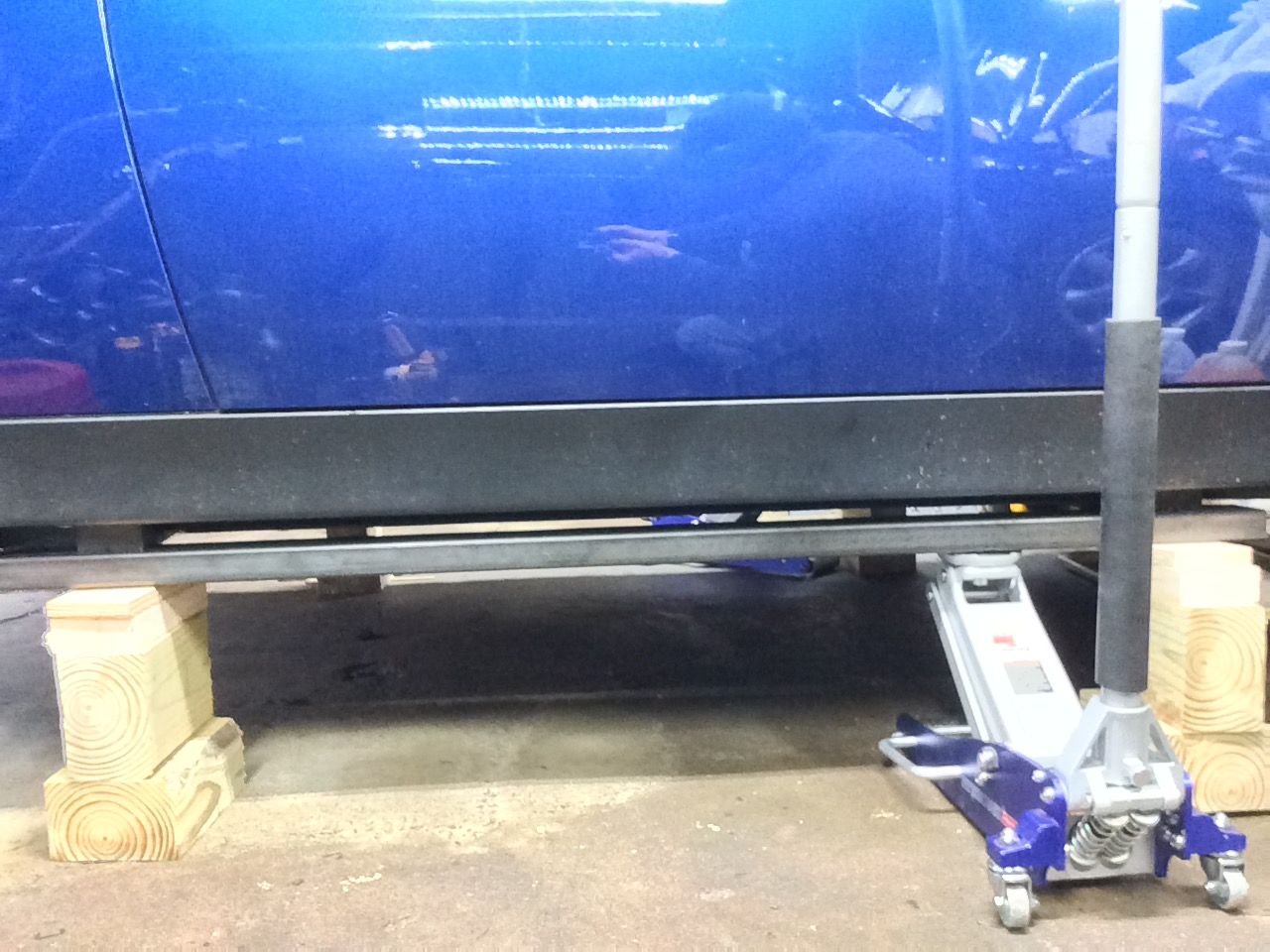

I have wanted a simple lift for Albert (for that matter, all of our MINIs). It needed to be something small that would fit in my small garage, which is also filled with junk. Yes, cleaning the junk out would help, but that doesn’t get me a lift and that is not as much fun as building a lift. And the lift would still have to be small. So, i see no point to cleaning out the garage right now, not when there is a project to do.
I had tried 4 HF aluminum floor jacks. This worked OK for changing tires, but I would not exactly trust a HF jack, well enough alone anyone else’s jack, to stay up if I am under the car. Because those 4 jacks use the jack points on the car, there is no place I deem trustworthy to put jack stands under the car. Plus, those would just get in the way when under the car. I have tried ramps, too. But, the smell of burning clutch kind-of turned me off of those. Also, they only get 2 wheels off the ground and generally, when under the car, it is nice to have all 4 wheels off the ground.
So, enter one of my favorite stores. Metal Supermarkets. If you are any kind of metal fabricator, you’ll love this place. Metal of all manor of shapes, sizes and flavors. After a bit of Mc/I calculating... No, just kidding... I eyeballed this one, I came up with needing 2 pieces of 60” long, 3”x1.5” rectangular steel tube with a 0.120” thick wall. I had some 0.250” steel plate laying around that I cut into rectangles that would fit inside of the lift-point feet on the MINIs to locate the steel tubes. After drilling a few holes in the steel tube, and slotting the holes at the rear end of the tube, I had something that looks like this:
Yup, a steel tube to span between the two jack points on the car so, with one jack, the whole side of the car can be lifted. The little steel plates are located to fit inside the jack points to keep the tube in place. The rear plates are located in slotted holes that allow them to be slid fore and aft to accommodate variations between cars. Nicely done, if I must say so myself. But there is more.
I also envisioned needing jack stand locators that would line up with the jack points to firmly hold the car up in the air. So I whipped up these:
Jack stand locators.
I envisioned that these would nicely match up with the HF aluminum jack stands. I was so looking forward to getting 2 sets of these. But the more I thought about it, I really didn’t like the idea of jacking up the car, one side at a time and resting it on these rounded pieces with nothing but the plastic jack points material keeping the steel tube from just rotating and falling off. Yes, a bit paranoid but that is the way I think.
So, those beautifully made jack stand locators went by the wayside in favor of hefty chunks of wood. 4x8 pressure treated solid lumber, to be exact, with some additional 2x4 spacers and a couple of sections of 3/4” plywood with a hole to match the bolt coming through the steel tube. Stable, yes. Over built, I hope so. Pretty, no. But it all works:
Blue up in the air...
And, it turns out the outside rear view mirrors are located just about at the CG of the car. Nice to know. I felt comfortable jacking the car up about 4” at a time on each side. This would be alternated from side to side until you get what you see above on both sides.
Why did Blue get the first use of these? Well, right now, Albert needs no work done on him and Blue did. Blue needed a rotted out exhaust band clamp replaced. I felt secure and comfortable under the car with this rig. I also fit nicely under the bar...
Yes, it is small enough to be stored inside my junk filled garage...

So... instead if jack stands, you used blocks of wood? I would have used the jack stands. I admire your creativity, though.
Old May 2, 2020 | 08:22 AM
  #218
Eddie07S's Avatar
Eddie07S
Joined: May 2010
Posts: 7,887
Likes: 1,429
From: Upstate NY
Correct...
Here are my thoughts as to why and this is not to say it is the best...
I felt that the jack pads on the bottom of the car were not wide enough to keep them from rolling over when the car is tilted and the one side is only resting on those, that steel tube and a set of jack stands that are are supporting the car through a rounded tube on the underside of the rectangular tube. And that round section is arranged in the same direction as the narrow section of the car’s jack pad. I know, I am raising one side by 4” and the car is, what, 60” wide, so the angle of tilt is minimal. But that didn’t belay my fears (paranoia?).
But another part of that fear comes from the way the car moves around a bit when being jacked up using this type of floor jack. The base of the jack stands is relatively small considering the 4 points it is sitting on, in comparison to the size blocks I am using and I don’t know how much side loading they can take when the car does move a bit. When I am jacking up one side of the car, that tube (and the weight of the car) is resting on the blocks on the other side, so hopefully it can’t go any where. I want the rectangle tube resting on a wide platform, so it could not tilt when jacking the other side of the car. I was actually surprised at how square and flat the sides of the 4x8 are. There is no rocking at all when one is on top of the other, which makes for a solid stack. All, in all, I more comfortable with this than the jack stands...

I figured I would check out my engine for mousy evidence now that our cats are getting beyond rodent chasing age. The good news is that there must be other appropriate places in Guilderland for them.
Thanks for that...
Glad you are having no issues...
The good news is that the cat scratch marks on the bonnet of Blue (our R50) rubbed out nicely, and he is looking very sharp. Now, the question is, how do I get those feral cats to go after the rodents?????

Is that yours? Wow!
For me:
Ceiling isn’t high enough... Concrete floor was only poured ~1 1/2” thick and is now crumbling... 2 car garage that was made for 2 cars, 1940s vintage (about the size of the modern MINIs )... On the wall side of the car, the jack needs to be at an angle to the car to operate the lever.
I have been known to “rent” a lift at the local MINI dealer. They only charge about $120 an hour, plus they throw in a mechanic...
